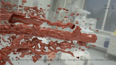

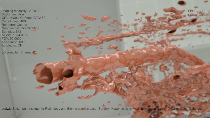

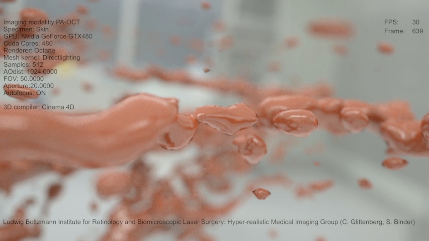

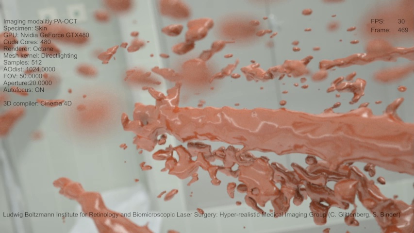

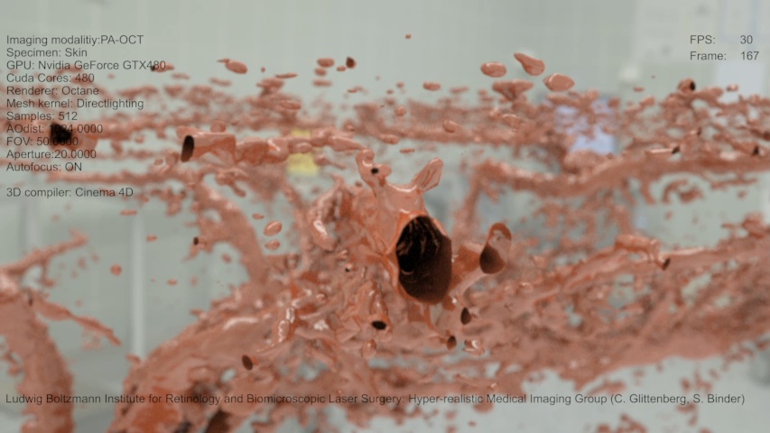

This is an example of an optical coherence tomography photo acoustic data set of the blood vessels in mouse skin. Visualized using automatic iso-mesh segmentation and GPU-Physically based rendering. Keep in mind the patient was alive when this was done. The process was automatic. There was no mesh modeling required. This was rendered entirely on a GPU (Nvidea GTX 480) using CUDA technology using Cinema 4D and the Octane Render Plugin.
