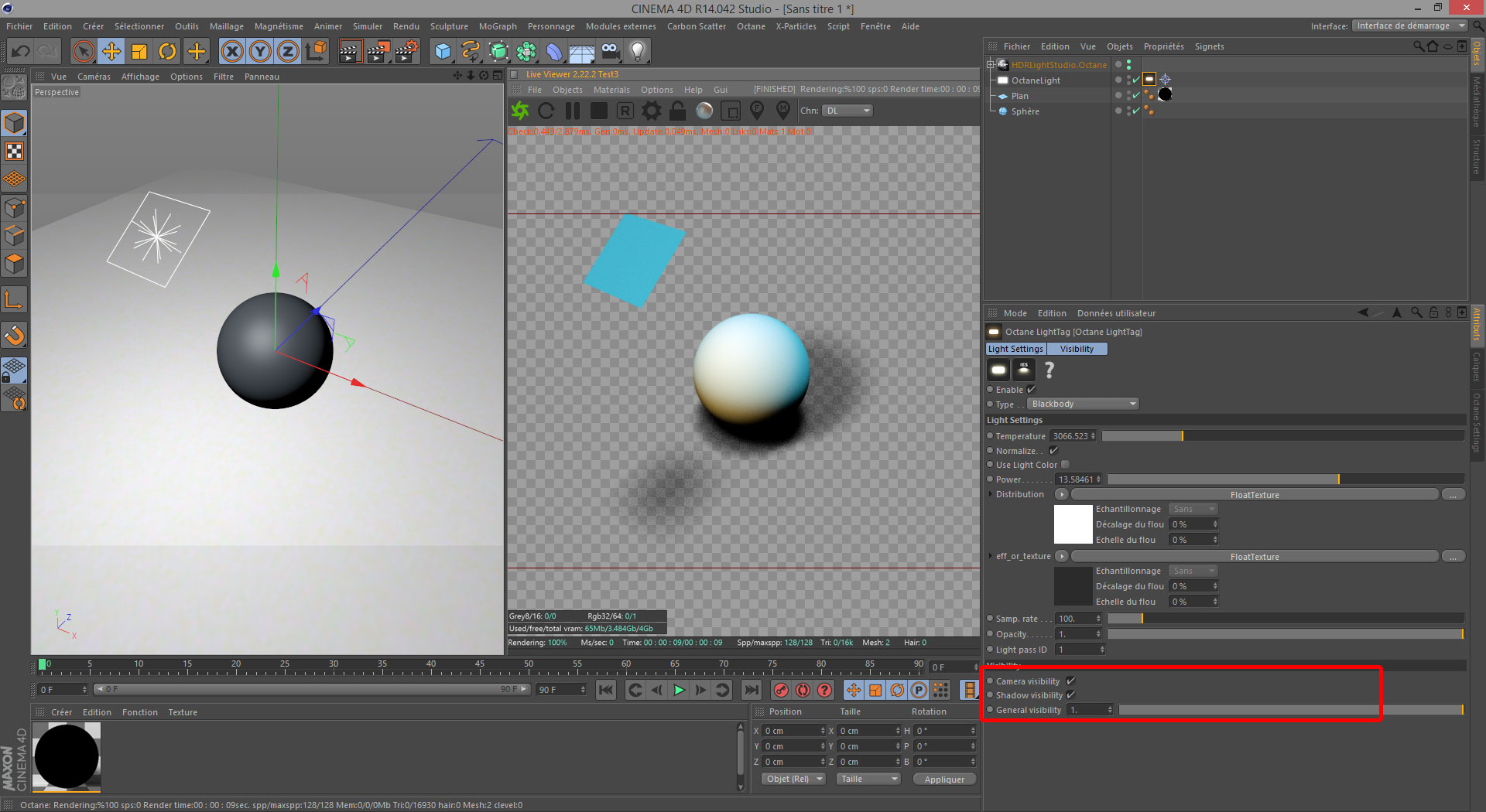

Hi I'm working on a project and I'm facing a problem.
I show you a simplified scene.
I'm lighting my scene with hdr and two area lights with disable shadows. Everything is ok but as soon as I turn the matte area lights shadows appears.
How can I avoid this?
I'm in a rush so thanks for any suggestion.
https://www.dropbox.com/s/3v9h75g8ggtfuc9/1a.JPG?dl=0
https://www.dropbox.com/s/858fpyew28mn5mj/1b.JPG?dl=0
Octane version 2.16.2
Direct Lighting Diffuse
Matte background problem - Urgent

Hope there is a fix for this, but seems that also in 2.22.2 behave the same.
Basically I want to brighten up some parts of my render using lights (hdri dosn't work in this case) without affecting shadows in the shadow catcher plane.

I try to explain better.
If I use only HDRI I have this clean matte
https://www.dropbox.com/s/je9qezbdvm8aw4e/2a.JPG?dl=0
but if I add also a light in the center of the object the matte is not working for me even if I disable shadows in area light
https://www.dropbox.com/s/4ig3llsx3kmquqz/2b.JPG?dl=0
Thank you again for your help.

Visibility parameters in the area light aren't about projected shadows from the light itself but projected shadow by the light panel itself (the polygons of the light object). It's the same parameter than visibility tab in Octane Object Tag. Unfortunately, it removes shadows from every light sources (environment and light) for the object with an Octane Object Tag, then it's not a solution for your problem.

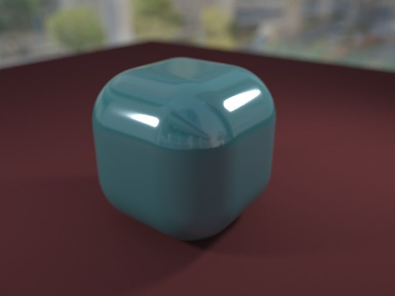

I don't know what you want to do but it's possible to create light passes.
By sample, for this kind of main render You may create these passes by sample For this sample i've added an object tag on the cube with Layer ID defined on 2 (all objects without specific layer ID are defined by default to be layer ID 1). In Render passes tab of octane render settings, i've checked ID1 and ID2 in Infos passes > Render layer mask. I've also checked in Lighting passes: Ambient light, Light pass 1 and Light pass 2.
In my object manager i've defined one of the Octanelights to Light pass ID on 2 in his tag.
I hope this will help you a little bit.
