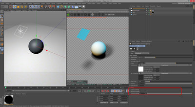

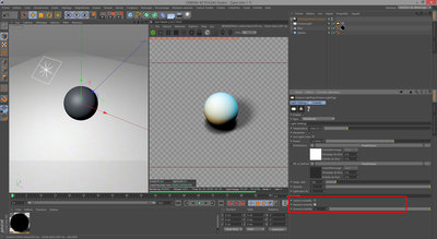

Hi I'm working on a project and I'm facing a problem.
I show you a simplified scene.
I'm lighting my scene with hdr and two area lights with disable shadows. Everything is ok but as soon as I turn the matte area lights shadows appears.
How can I avoid this?
I'm in a rush so thanks for any suggestion.
https://www.dropbox.com/s/3v9h75g8ggtfuc9/1a.JPG?dl=0
https://www.dropbox.com/s/858fpyew28mn5mj/1b.JPG?dl=0
Octane version 2.16.2
Direct Lighting Diffuse

Curious... Maybe it was a bug in 2.16.2. With 2.22.2 test3 it works fine.
But, your shadows in your sample are very hard edged (it's unusual with a HDR light) then it's maybe not shadows but the rear of your lights. In this case, you should disable the camera visibility and/or set the opacity of your lights to zero.
EDIT : Oooops, sorry, i did not understand your problem correctly...

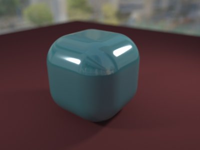

I try to explain better.
If I use only HDRI I have this clean matte
https://www.dropbox.com/s/je9qezbdvm8aw4e/2a.JPG?dl=0
but if I add also a light in the center of the object the matte is not working for me even if I disable shadows in area light

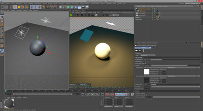

https://www.dropbox.com/s/4ig3llsx3kmquqz/2b.JPG?dl=0
Thank you again for your help.

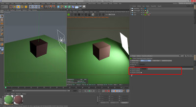

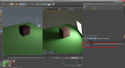

I don't know what you want to do but it's possible to create light passes.
By sample, for this kind of main render
You may create these passes by sample
light-passes2.tif
For this sample i've added an object tag on the cube with Layer ID defined on 2 (all objects without specific layer ID are defined by default to be layer ID 1). In Render passes tab of octane render settings, i've checked ID1 and ID2 in Infos passes > Render layer mask. I've also checked in Lighting passes: Ambient light, Light pass 1 and Light pass 2.
In my object manager i've defined one of the Octanelights to Light pass ID on 2 in his tag.
I hope this will help you a little bit. ;)
