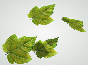

Just noticed that the shadow cast from a leaf with an opacity mask is casting a shadow of the poly not the leaf.
I tried it out in standalone and it's broken there to, unless I'm doing something wrong.

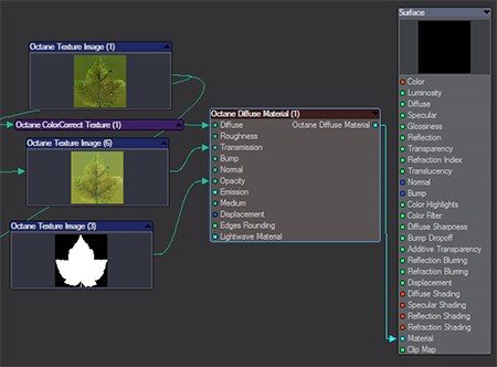

B&W image plugged into opacity channel.
Keith
wired nodes

shadow of poly not leaf

I think that your problem can be that you have "Alpha Shadows" option disabled in the kernel node.

Thanks Juanjgon
That was it. I forgot I turned that off :oops:
