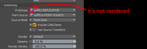

When a replicator is used as a prototype the final output is not rendered in Octane (but rendered properly in Modo). I am on demo version, and don't know if this is fixed in 2.21.
Please help.

And here is a sample scene attached. The are no replicas of replicas visible in OR.
Hi - you are right. I am doing a lot of reworking of the geometry extraction code from Modo at the moment, and with that version of the plugin this scenario works, however on the current release it does not. The workaround is to make only "Replicator" visible, "Bake Geometry Cache", select all the meshes in the Bake Geometry folder and "Merge", then use that merge mesh as the Replicator source.
I hope to have the re-work geometry version of the plugin available in the next month. Sorry for wait.
