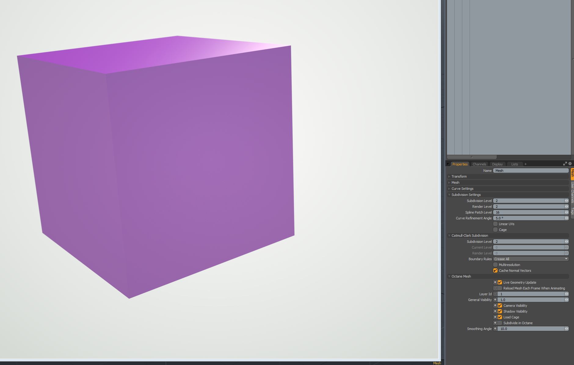

Tried to use rounded edges recently and found the following issue:

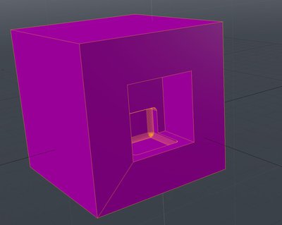

This is my geometry

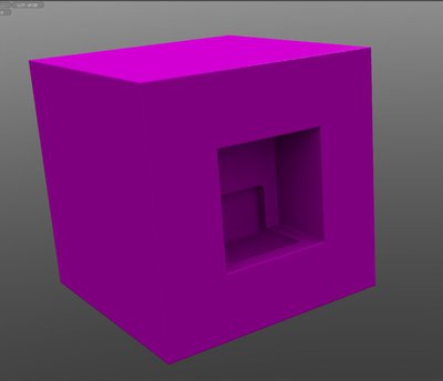

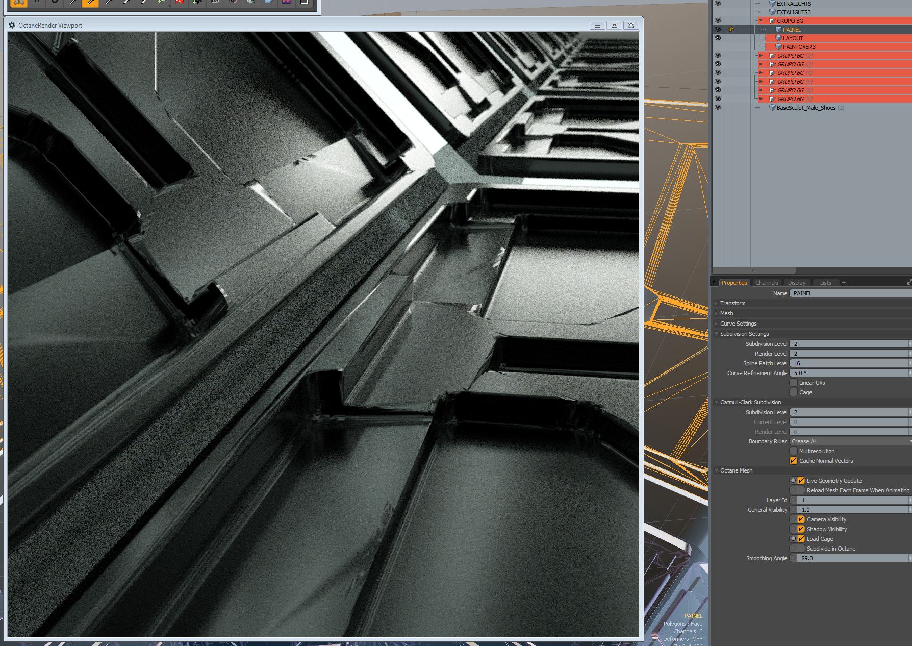

This is modo's render using rounded edges

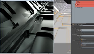

This is my geometry in octane:
This is what happens when i use "load cage" so i can round it's edges:
Hole is gone...

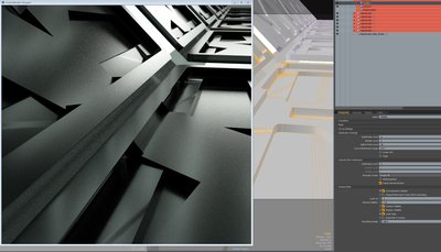

This is what happens when try to use rounded edges WITHOUT "load cage":
Just some artifacts on the normals/reflections? no rounding on the edges.

Round edges needs vertices to be welded at geometry edges - and the only way to do that is to tick Load Cage (which in effect loads the non-subd mesh from Modo)...so the Modo cage geometry will need to have the hole in it. If you press Tab, does the hole show?

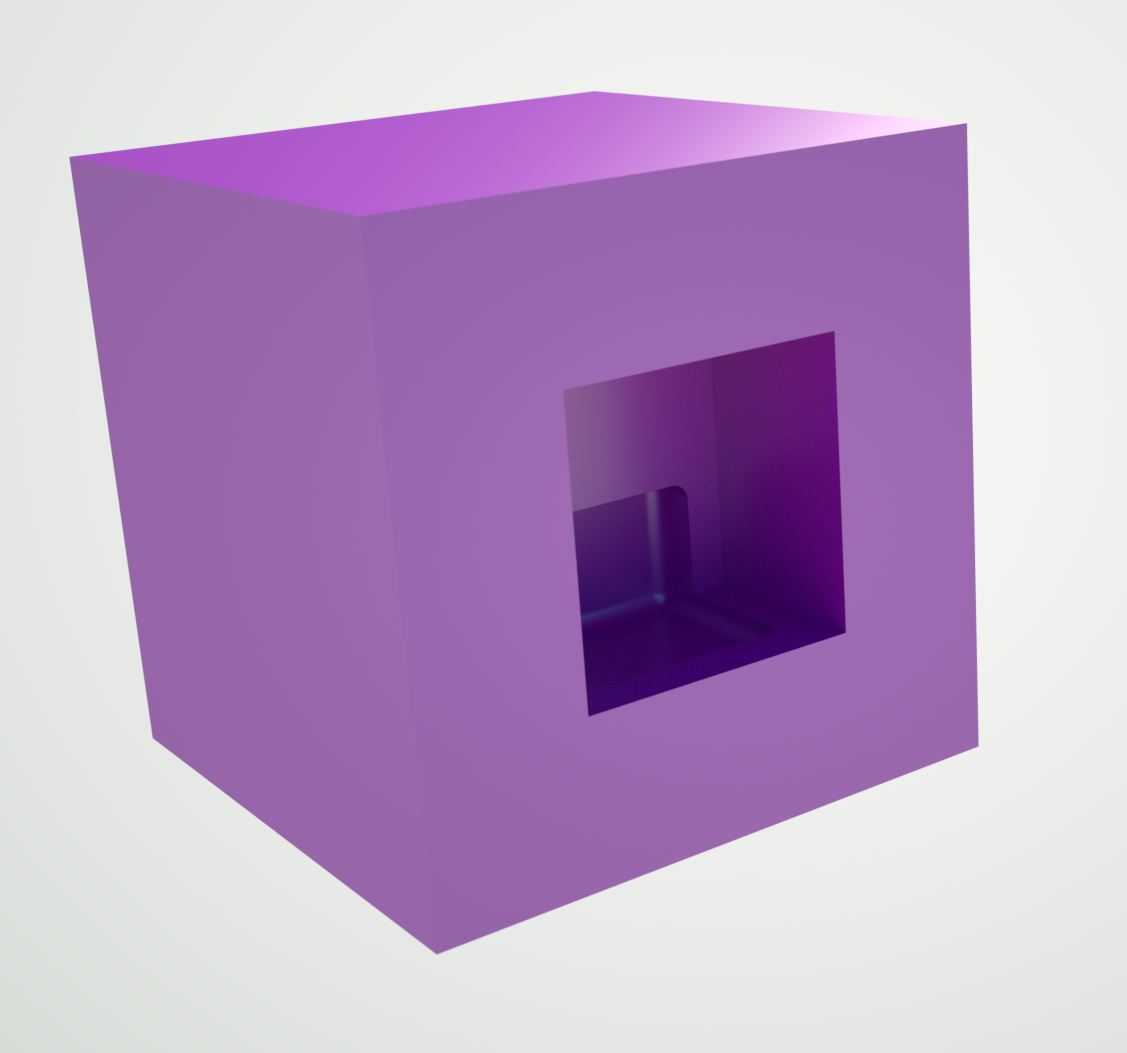

Ok, so, check this out:

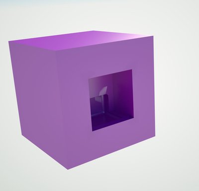

This is my geometry
This is what happens when i turn Load cage on:
Again, how it shoul look like(modo render)

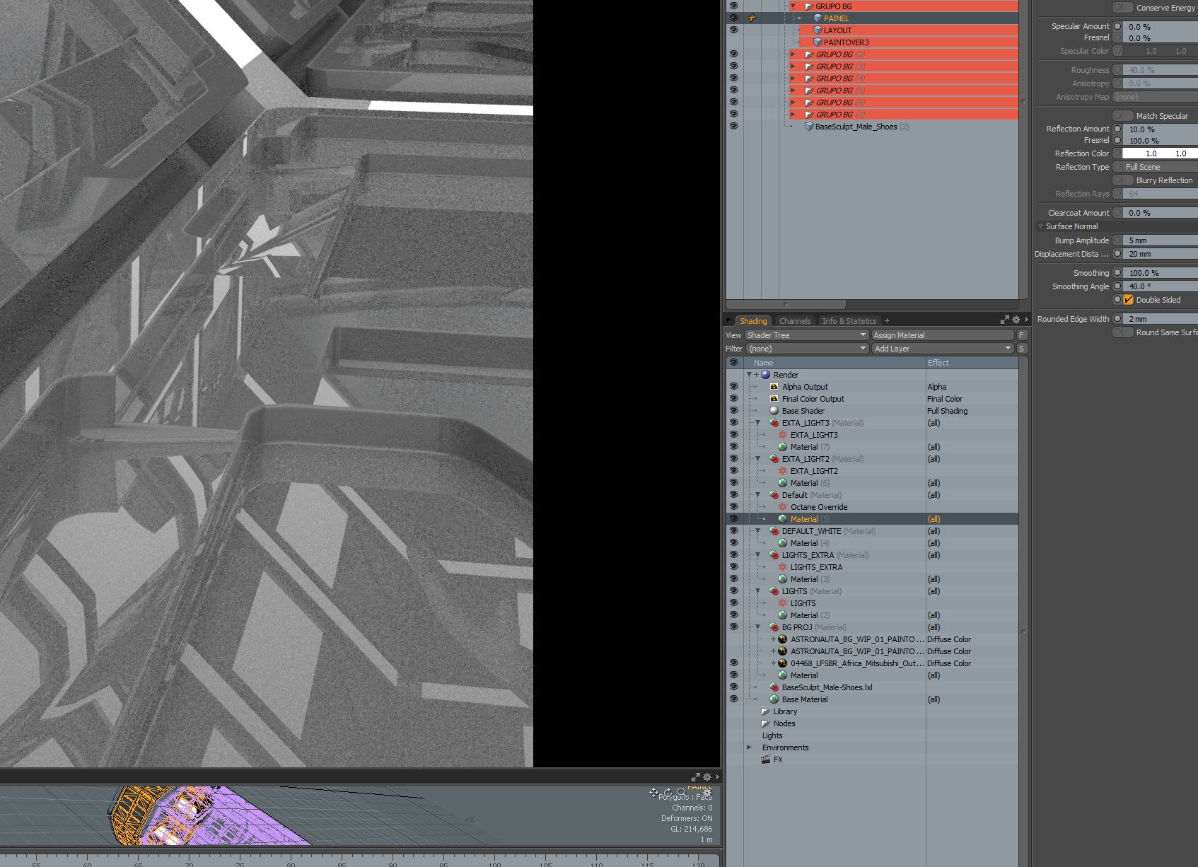

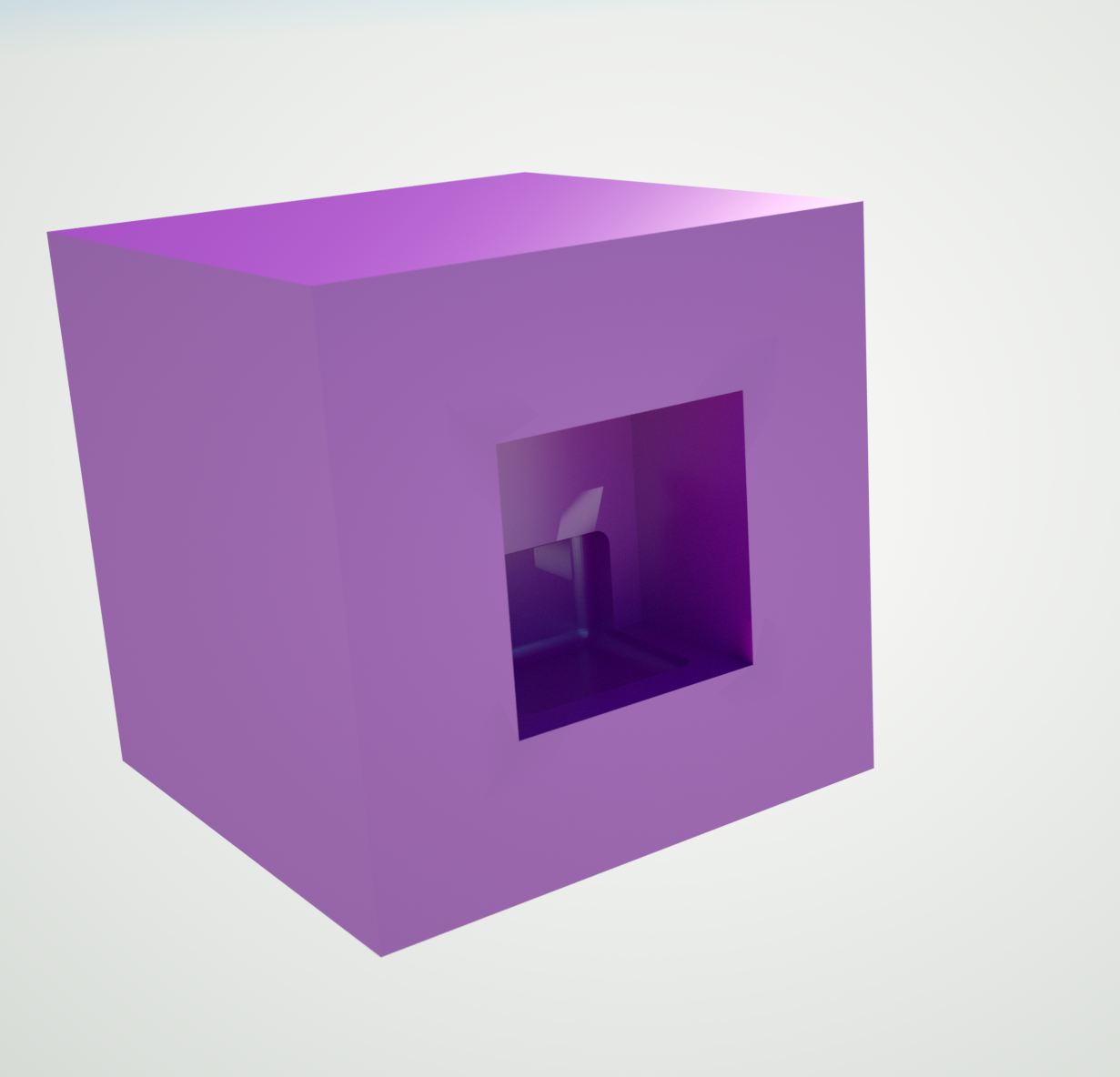

Then, i decided to tesselate my mesh, and look what happens:
It, kinda starts to work, but all wonky and jaggy.

Hi Raf - it's a little hard to tell exactly what is going on with these scenes. Would it be possible to send me the geometry which you are trying to get round edges on (particularly the cube with the hole)? Then I can check in more detail.
Two other things 1) it would be worth adjusting the ray epsilon, just to make sure it is not that causing the issues, and 2) if you also render out the wireframe pass, you can check if there is a geometry glitch (although it won't tell you for sure if the edges are welded).
