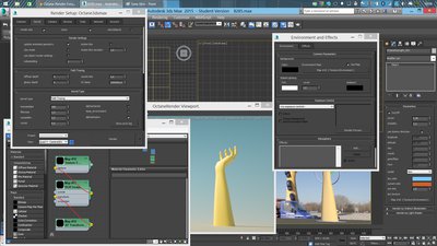

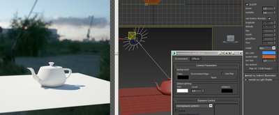

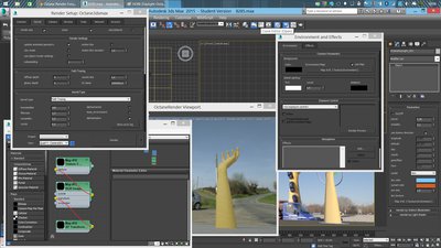

I want to use the daylight whith a sky texture, but the texture don't appear
I use the environnement map, but no change, I only have the default sky. But, if I unchek the daylight button "on/off" to stop the daylight, it work, but with only the lightning from my HDR file.
I want to use both daylight for the lightning and HDRI (sky texture) for reflection et global illumination.
Where am I wrong with those settings ?
