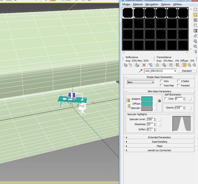

if i open the max file and use the octane "material convert" all textures gets "texture is missing".
if i import the obj file, the textures are not setup :-/
does anyone know what i do wrong?

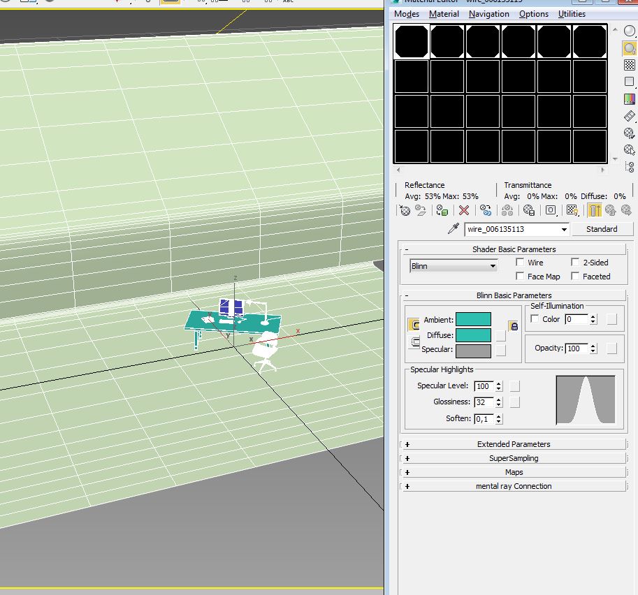

i have attached three images.
shows how the materials look like when i import the obj file - no images linket at all :-/

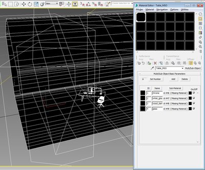

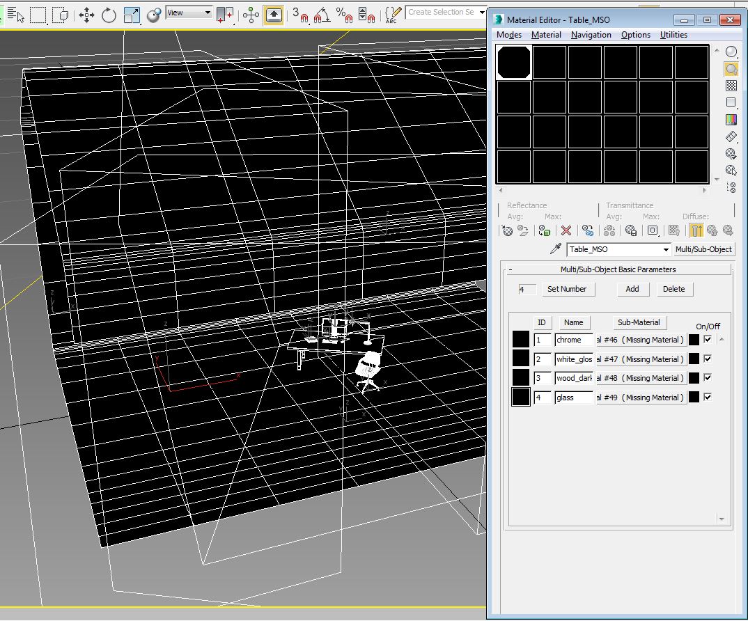

max 1.jpg + max 2jpg
show the missing material in the max file :-/

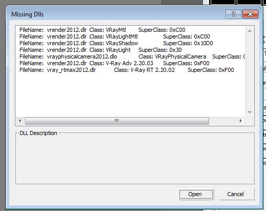

vray
this shows the errors i get when i open the file - as i don't have vray. could this cause the problems?

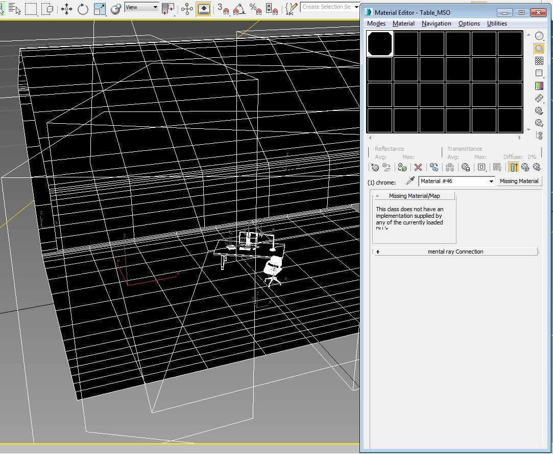

Jorgensen wrote:- as i don't have vray. could this cause the problems?
Correct. If max can't see inside the vray materials due to not having plugins then Octane can't either for conversion.
obj does not have correct materials or maps.
fyi:
Did a quick convert and rezipped. saved as 2012. no love given to the mats almost a simple convert - just repaired broken bits and links.
