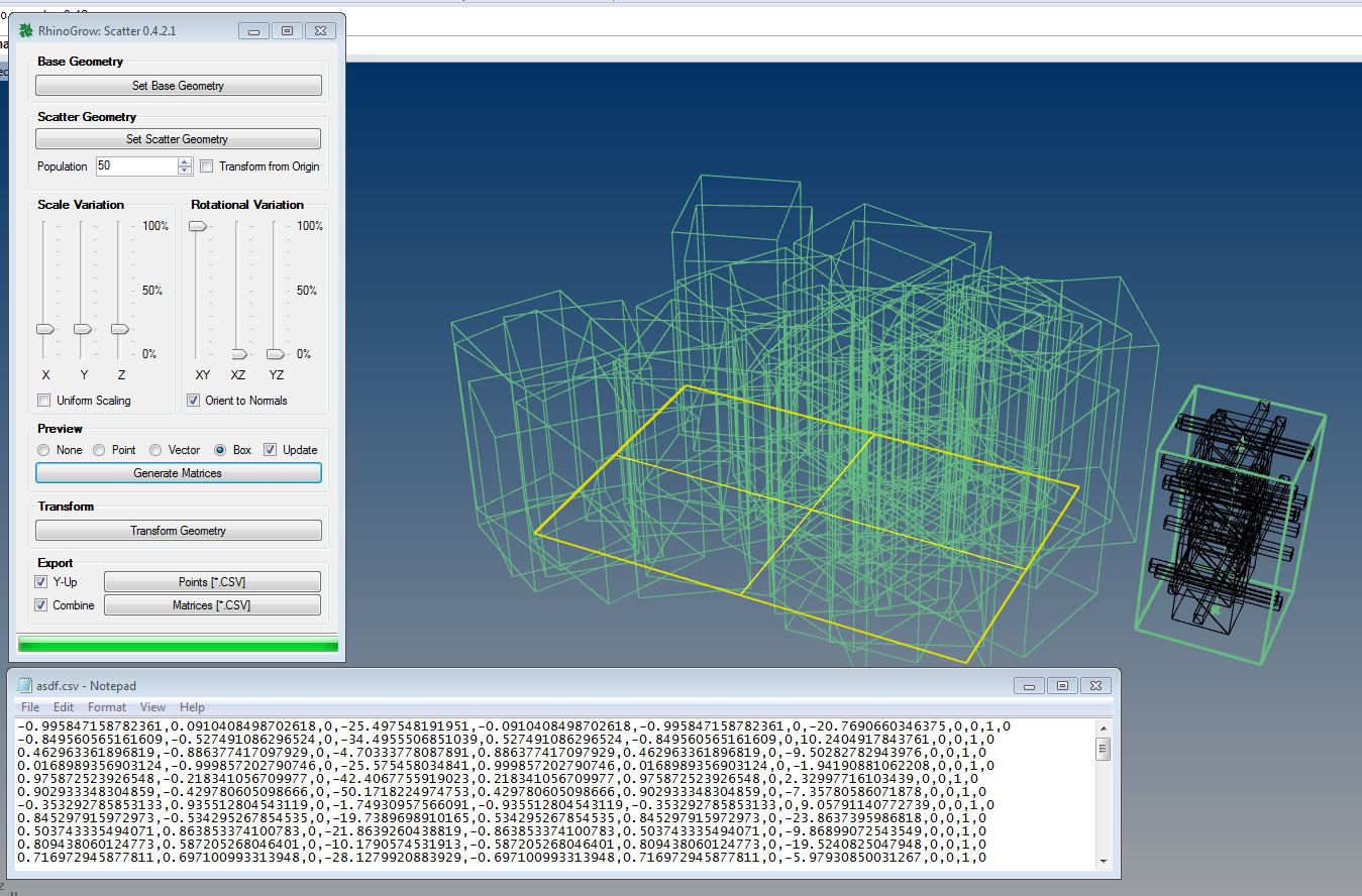

Hi sfuga - I had a quick double-check about the matrices - I am unable to re-create the issue using the default settings. Does your viewport produce something akin to the attached? Could you please email me a screenshot (similar to the attached) as well as the relevant files? (Rhino file with base and scatter geometry, plus .obj file for Octane, plus the .csv file that was generated). I'd be happy to have a look.
Send to [email protected] or fill the form at http://rhinogrow.camnewnham.com/?page_id=14
