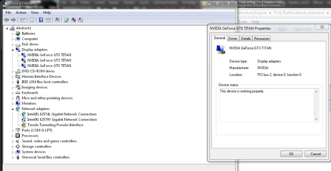

what does device manager->display adapter, say?

All very good questions. I don't have sli enabled but I did try that to see if I could "force" octane to use them all but no luck. I tried every combination I can think of in each slot thinking that was also the case and that didn't help. I even tried different slots at different speeds (x8,x16,x4 etc) and that did nothing. The device manager shows everything working just fine as well. I'll attach a screen shot of that too. Also, I tried the newest version of octane and nothing changed for that either. I'm wondering if octane is the culprit or if there's something else altogether going on.
