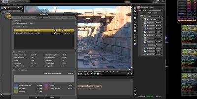

Ok so I have 3 x Titan's, all of which I know work and function correctly (I went into the nvidia control panel and forced octane to use each one individually as a test). The problem is it refuses to see/use all 3 of them, only 2 will ever get used. I've tried every driver from the nvidia site, along with a combination of other gpu's (980, 780ti etc) in place of the titans just to make sure it wasn't the cards themselves, but nothing is working. I'm seriously at a loss :/ please help!

HELP! I can't get octane to use all 3 of my gpus

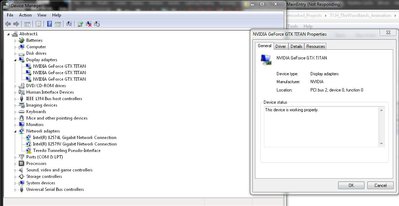

what does device manager->display adapter, say?

All very good questions. I don't have sli enabled but I did try that to see if I could "force" octane to use them all but no luck. I tried every combination I can think of in each slot thinking that was also the case and that didn't help. I even tried different slots at different speeds (x8,x16,x4 etc) and that did nothing. The device manager shows everything working just fine as well. I'll attach a screen shot of that too. Also, I tried the newest version of octane and nothing changed for that either. I'm wondering if octane is the culprit or if there's something else altogether going on.

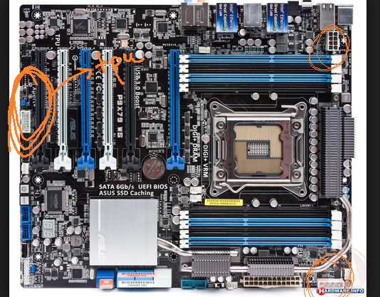

see ss.
also what does the tpu-do?
A second microprocessor, dedicated for automatic system tuning, is embedded in the ASUS P9X79 Pro called TPU. With a flick of a switch, the system automatically adjusts settings to an overclocked and stable state. This feature is also accessible in software mode through ASUS TurboV EVO easy overclocking tool for a single-click auto-system level up. The TPU not only allows a finer configuration of voltage control beyond the ability of any existing controllers, the real-time detection of the exact voltage reading are also made available through it. This is especially essential for overclocking purposes, ensuring the added on voltage can be minimized, whether it is for manual or automatic overclocking purposes. The TPU is connected to both the SMBUS and the CPU directly, to control the behavior of the rest of the system.

see ss.
