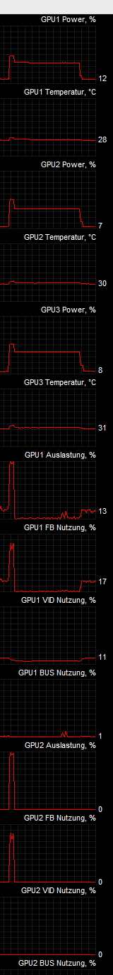

I still have the old problem, that Octane Server is not releasing the GPUs after a render ... it keeps them at 50% power when rendering is finished instead of dropping down back to idle.
I made a screenshot in MSI Afterburner to explain:
1. You can see that the GPU power of the GPUs is in the beginning around 10%. That is with Octane Renderserver running, but after a freesh start, i.e. it has not done any rendering so far, but I can acces the Live DB etc in Blender.
2. Tallest Peak. This is Octane Server rendering my small demo picture of just a cube. You also see that in the tall "GPU Auslastung" (usage) peaks at that moment.
3. Long high plateau in the middle. This is after the rendering. It does finish the job (2000 of 2000 samples), but it never drops back to 10% .. it keeps the GPUs around 50% power usage.
4. Drop at then end. This is me closing and restarting the Render Server. it is then back to 10% ... until you render soemthing again...

voon wrote:I still have the old problem, that Octane Server is not releasing the GPUs after a render ... it keeps them at 50% power when rendering is finished instead of dropping down back to idle.
I wonder if this is a Blender issue? I noticed that Cycles does the same thing:
http://blenderartists.org/forum/showthr ... -rendering
