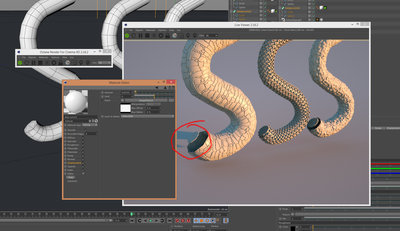

Hi there,
I put a translucent displacement material on my crystal-mesh (not meth!) but unfortunately it kind of destroys it at the corners (s. picture).
I already used the "optimise" command on the mesh with no result. Any suggestions?
Thanks alot!

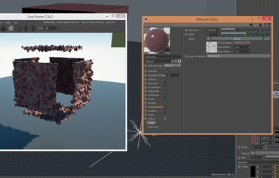

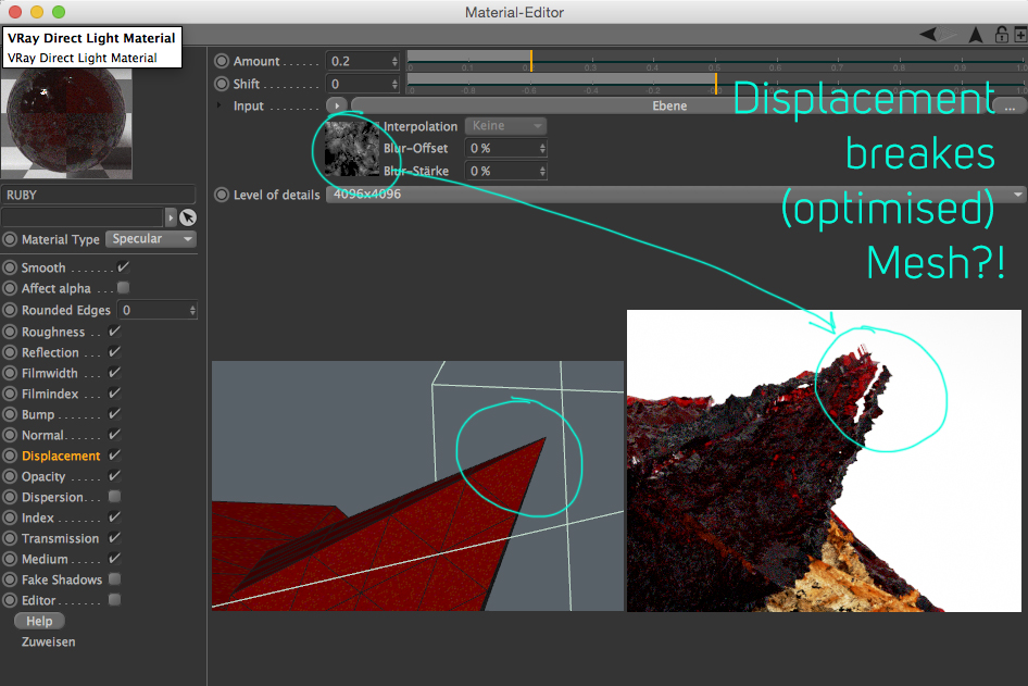

Hi there,
for the sake of not making a new thread i will posting my problem too in this one!
also got some trouble with displacement on corners =/ is this a "normal" behavior of octanes displacement handling or is there a solution for it without patching arround the UV! :cry:

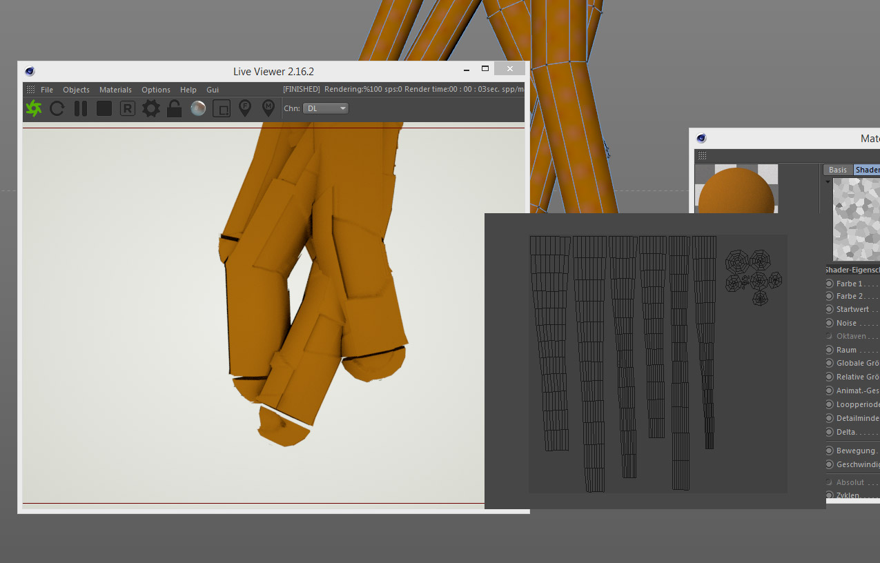

nbeyond
Posts: 67
Joined: Sat Feb 28, 2015 4:59 pm
tryed some noise displacement with the example scene - corners always breaks up with "noise"?! =/

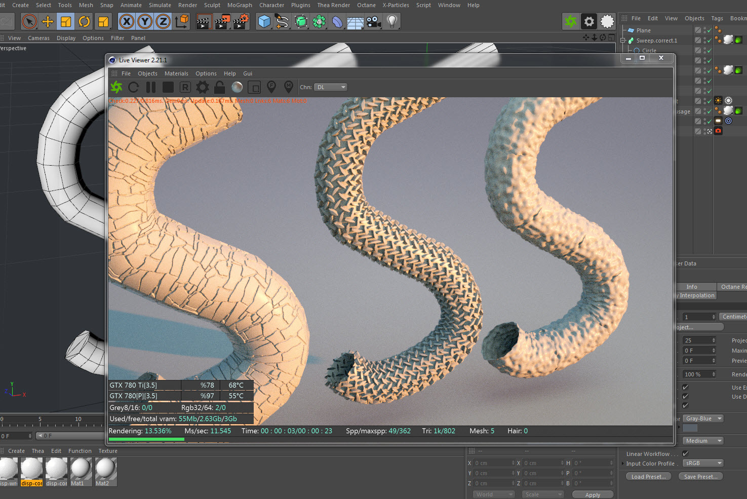

I think you don't know how works C4D shaders in plugin. Do you expect it's interpreting in gpu as tileable? No. It converts that to a image.
Always you should keep to feed the gpu by a tileable texture. See my sample for correct usage.

i'm both. It depends to what are you doing. I hope that you understand the logic on c4d shader usages. Also it does not work on 90 degree connections i think. Make some bevel there.

Try changing the value shift.
Example:
Amount 0.010
Shift -0.010 or -0.005
and pyramid try using spherical UV
