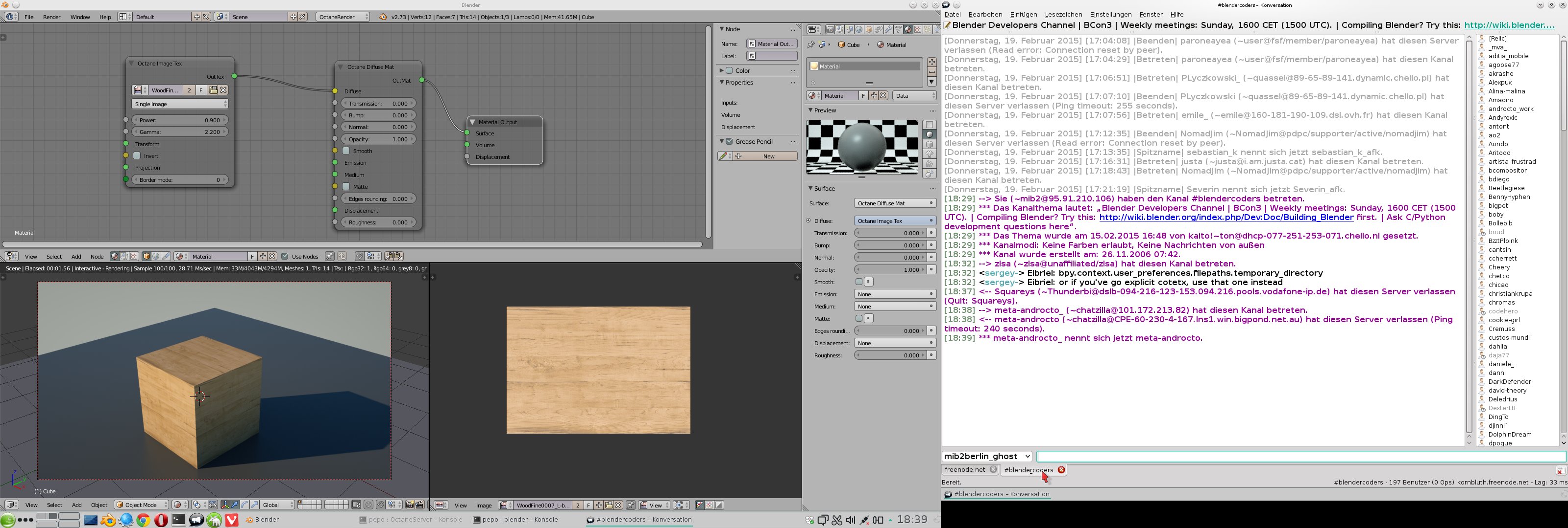

Here's what I do -- could somebody please tell me what I'm doing wrong?
1) I have the default cube.
2) Add an Octane Image Tex
3) Open a .png image and Assign it
4) Open the .png in the UV editor
5) In Edit view w/ cube selected, go into UV-unwrap/Cube projection
6) The .png is now unwrapped on the cube - and it is visible in Material view.
7) In Rendered view however, the cube is rendered without the .png: Just the default cube in the default blue Octane sky.
So I'm obviously missing one or more steps somewhere along the way...

Hi, you have to add a Octane material and image texture node too.

Hi, thank you!mib2berlin wrote:Hi, you have to add a Octane material and image texture node too.
Cheers, mib
May I ask in which order the nodes should be connected? I should have an Image Texture, an Octane Mix Material (for instance) and a Material Output, isn't that right?

Thank you very much for your time!mib2berlin wrote:Hi, simplest textured mat is:
Cheers, mib
EDIT: Sorry for second display screeny.
It's weird, everything looks the same here - except for the render (and the second screen
Latest OctaneRender for Blender. Windows 10, i7 quad 3.7GHz, 16GB, 2xTitan.
