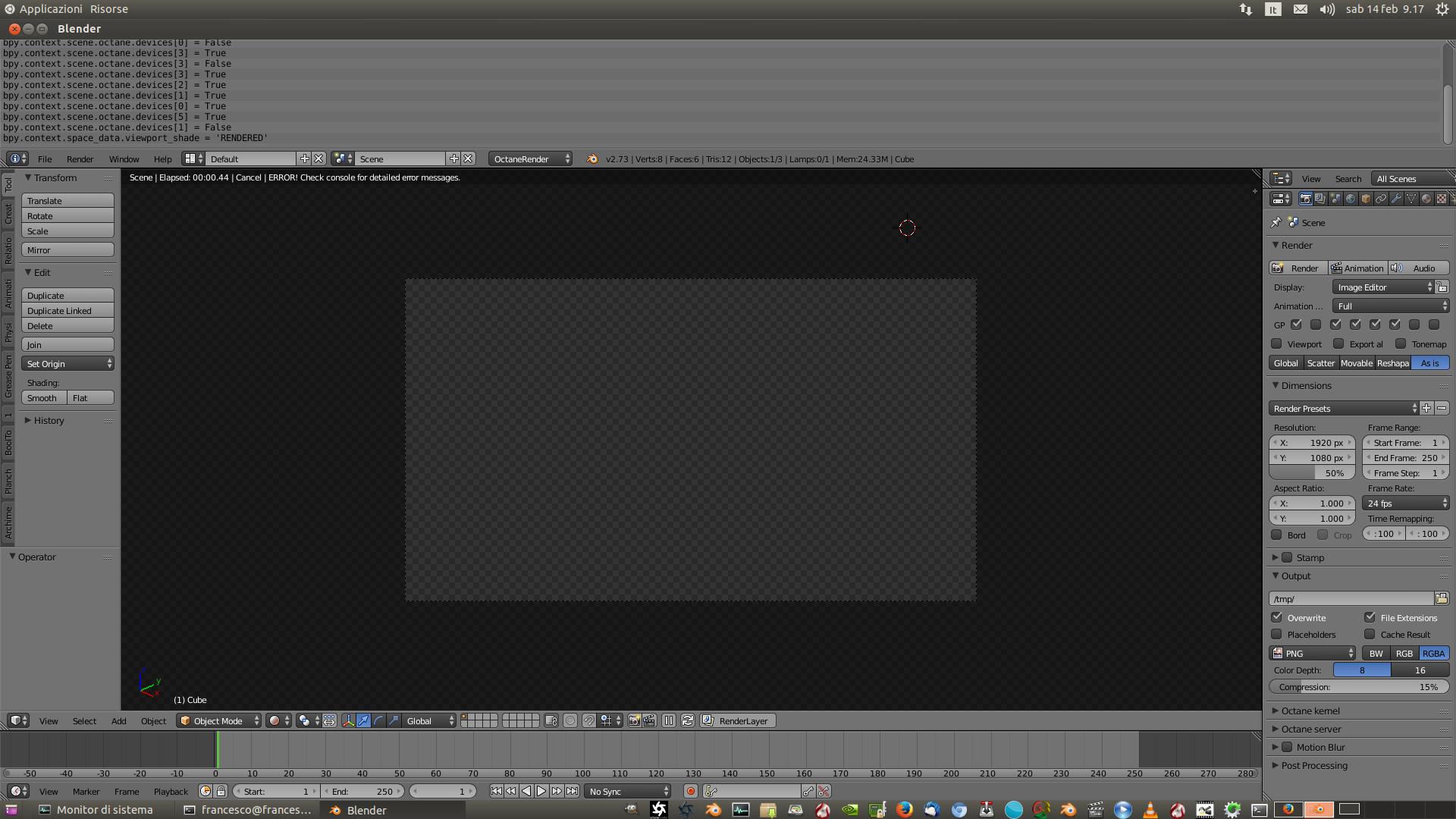

Hello Jim,the problem does not change, the same error..
Can't write float to static pin 'unknown' (P_UNKNOWN, type PT_UNKNOWN) of node '' (NT_UNKNOWN, 0x7f707cfdbca0)
Tried to access null node
Unknown pin ID 246
My system is Ubuntu 14.10 64bit..
My Computer:i7 2,6ghz ram 8gb schede video nvidia 9600tso 512mb gtx560ti 1gb mainboard asus p6t se sistema operativo:Ubuntu 14.10 64 bit

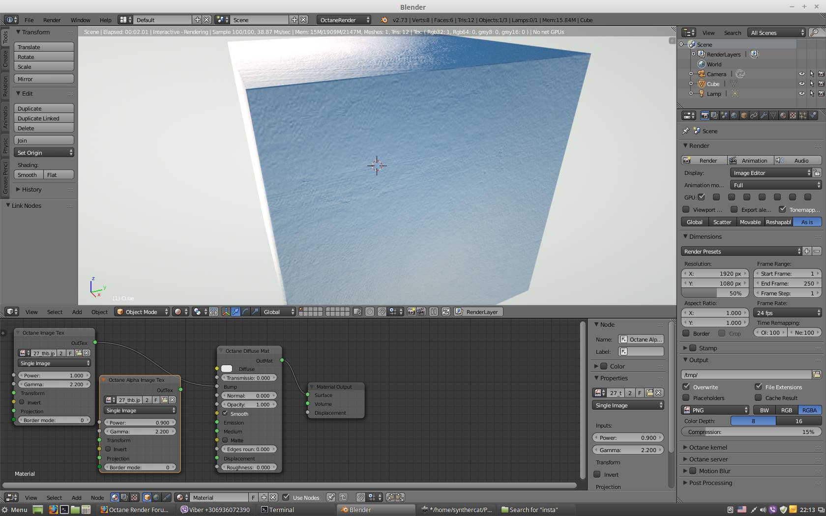

1. I had mentioned this before, it must have been overlooked. Alpha image texture does not seem to work for bump. Only Image texture does. This cube is bumpy but when I connect the Alpha image texture node to the bump (it was the exact same jpg to it), the bump disappears and the cube becomes smooth again

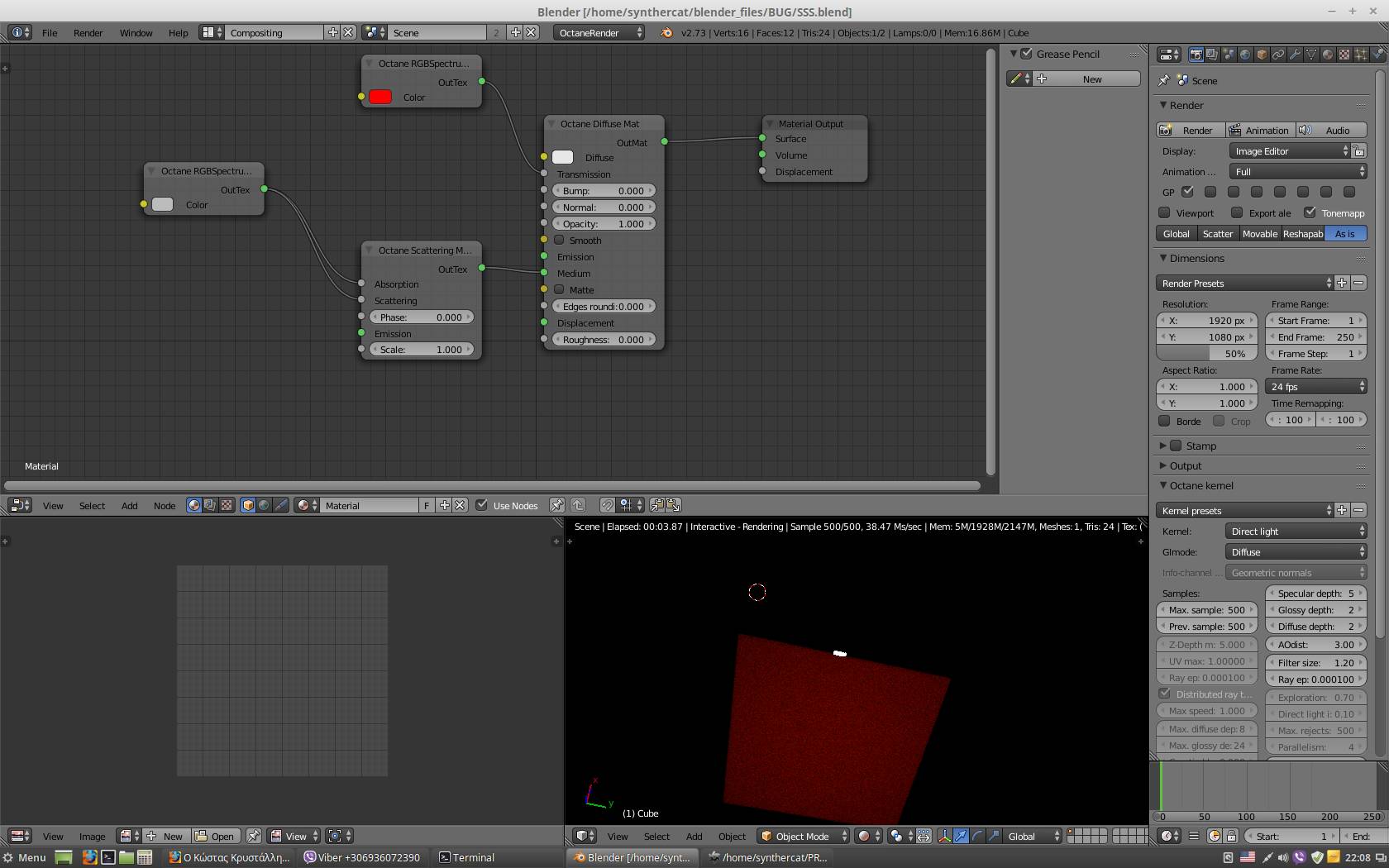

2. I've been reading about the SSS mat and how to use it. I've tried it and although I made it work, some settings seem to not function. When I copied my scene to Octane Standalone I realised they do work there. I am talking about the Absorption & Scatter colours... in Blender they behave as set to 0 for both. You can see the comparison of the pic in bug 2 and bug 3. I got the same settings, they should produce the same result
Here is my Blender file :
SSS.blend
(495.08 KiB) Downloaded 186 times
Also the scatter direction set to -1 should make the transmission colour disappear because I got the view-port on the opposite side of the lamp. The direction does not seem to affect anything in Blender and neither on Standalone too

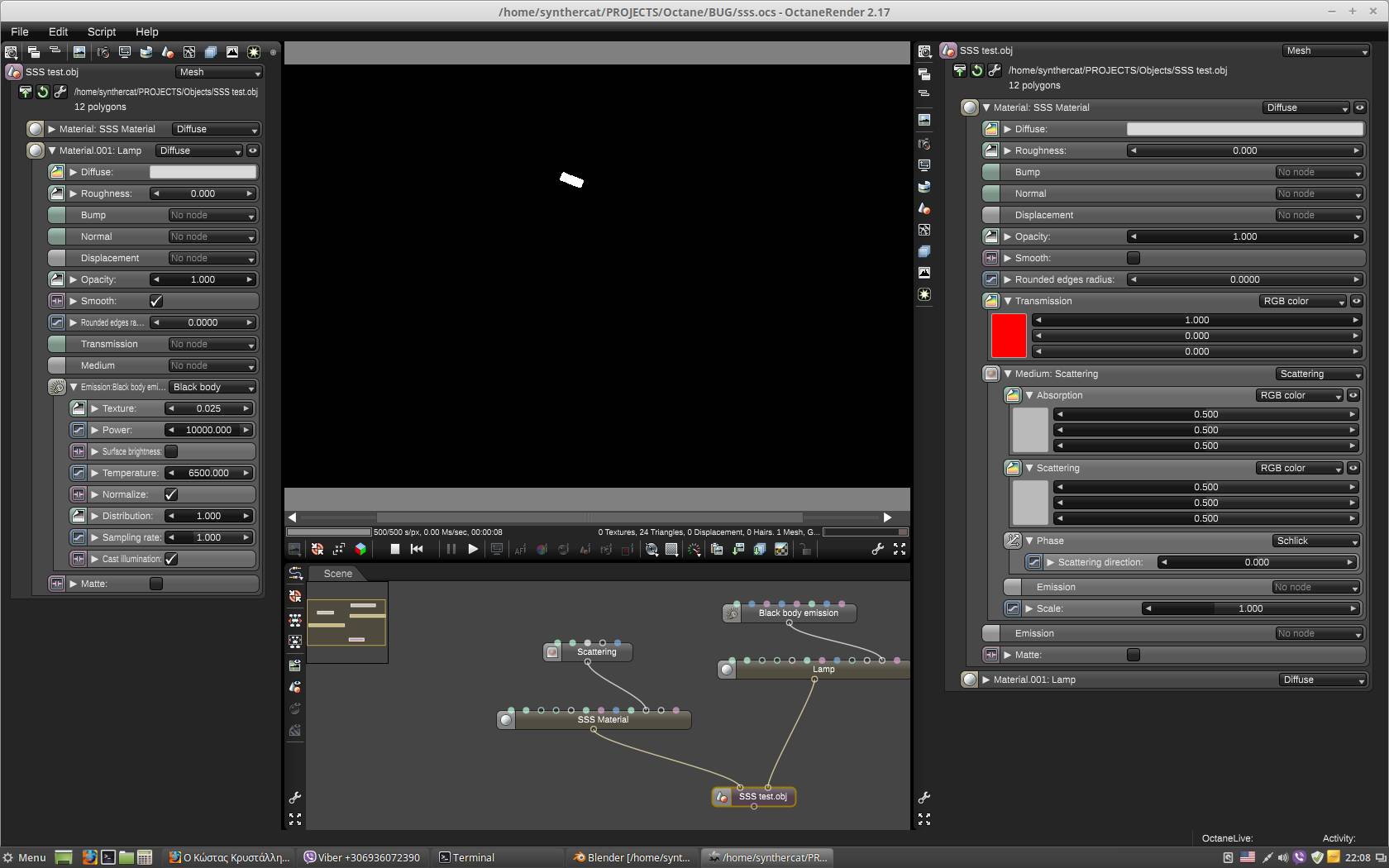

3. Standalone Octane 2.17 64bit linux
(I post this here cause it has to do with image comparison of bug 2)
As you can see I got both absorption and scatter colours set to 0.5 RGB... but when I click on the colour to open up the colour picker they read as 0.7297401 RGB inside it, setting 0.5 there, make the node inspector turn to 0.2176376. Is that normal? Does it have to do with linear correction or something?
Thank you again for your work JimStar.

Hello Jim,yes is it from this installer and Is it on any scene, even on default cube
Octane: WARNING: only node-materials are supported: material "Material"
Octane: WARNING: only node-textures are supported: texture "Tex"
Octane: ERROR loading mesh. Server response:
Tried to access pin via an invalid ID P_RENDER_PASS_POST_PROCESSING (155)
Tried to access null node pin
Node type 86 is either unknown, a linker or incompatible to static pin 'unknown' (P_UNKNOWN, type PT_UNKNOWN) of node '' (NT_UNKNOWN, 0x7f709555bca0)
Tried to access pin via an invalid ID P_FOCAL_DEPTH (49)
Can't read float from static pin 'unknown' (P_UNKNOWN, type PT_UNKNOWN) of node '' (NT_UNKNOWN, 0x7f709555bca0)
Can't write float to static pin 'unknown' (P_UNKNOWN, type PT_UNKNOWN) of node '' (NT_UNKNOWN, 0x7f709555bca0)
Unknown pin ID 253
Tried to access pin via an invalid ID (253)
Unknown pin ID 253
Unknown pin ID 246
Tried to access pin via an invalid ID (246)
Unknown pin ID 246
Tried to access pin via an invalid ID P_MIN (107)
Tried to access pin via an invalid ID P_AO_DISTANCE (7)
Tried to access pin via an invalid ID P_RENDER_PASS_EMIT (143)
Can't read bool from static pin 'unknown' (P_UNKNOWN, type PT_UNKNOWN) of node '' (NT_UNKNOWN, 0x7f709555bca0)
Tried to access pin via an invalid ID P_RENDER_PASS_ENVIRONMENT (144)
Tried to access pin via an invalid ID P_RENDER_PASS_DIFFUSE_DIRECT (141)
Tried to access pin via an invalid ID P_RENDER_PASS_DIFFUSE_INDIRECT (142)
Tried to access pin via an invalid ID P_RENDER_PASS_REFLECTION_DIRECT (147)
Tried to access pin via an invalid ID P_RENDER_PASS_REFLECTION_INDIRECT (148)

That 's the error that I get from the command Octaneserver &
When you launch and run a blender render both the default cube that one scene the error is always the same ...
/usr/local/OctaneBlender ./blender -w
Color management: using fallback mode for management
found bundled python: /usr/local/OctaneBlender/2.73/python
trying to save userpref at /home/francesco/.config/blender/2.73/config/userpref.blend ok
Tried to access pin via an invalid ID P_EXPLORATION_STRENGTH (42)
