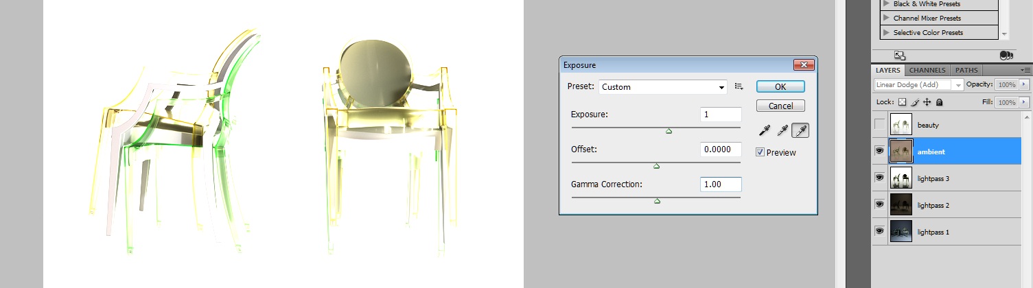

in PS i have:
1 ambient pass
1 lightpass
when adding linear dodge the image becomes too bright, i need to change the fill value for correction?

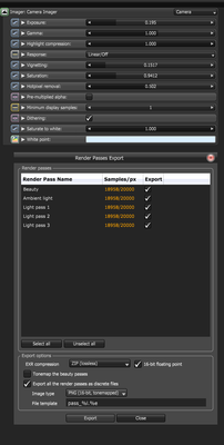

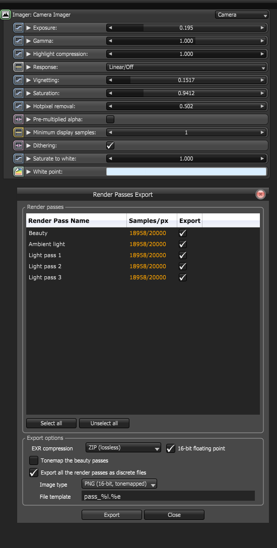

What are your imager settings? You need to make sure you are working in linear color space. Can you try to set your gamma to 1 and the response to Linear/off? This should add up in post (you need to gamma correct the image in Photoshop afterwards because otherwise it will look too dark.).

changed the gamma to 1 in standalone + linear response, it get`s better, but it`s too bright when combining them in ps (cs4)
do i need to change exposure to 2.2 in standalone?

yep that does the trick! thanks!
