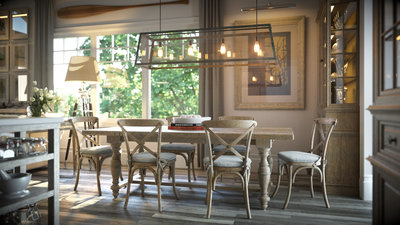

Hi All,
Playing with the Linear Response curve. I likey! Definitely much easier to get more accurate colour representation and shadow depth. Feels like I'm also seeing way more light temperatures. Not to mention much more room to play with adjustments in post. Especially when saving as an EXR (32bit).
So no biggie. Messing with a tiny dining room trying to find decent settings. 98% straight Octane, 2% minor targeted dodge and burn in post.
Info:
Octane Max Plug 2.11.1
-PT 6144
- Filter 1.0
- caustic blur 0, GI clamp 5.0
-gamma 1.8
-hotpixel 0.4
-camera response Linear
-diffuse bounces 8 (coherent mode)
- 2+4 Titans (2 local, 4 net)
- 1hr. 27min.
Best,
O
Residential Dining - Linear Response Testing

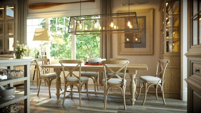

Can you render a comparison with the default 3ds max plugin response (agfacolor futura...)?
Most of the time I'm using the default response. It has a little bit more contrast than linear but has this green/yellow tint and you always have to fiddle around with white balance.
Would be nice to have a response curve that has a neutral white point but with more contrast.
Are you guys using all of the response presets? I could easily live without most of them and have some more neutral ones...

Great work!! It looks very real and sharp without being "bright white"
p3taoctane - Haha, thanks man.
itsallgoode9 - To be quite honest, it's taken me years to 'try' to understand LWF. (I still don't think I get it). I'm not sure if working in Linear Camera Response is the same thing. However, in my workflow, I only adjust texture saturation in PS. I adjust overall image gamma in camera to get image contrast. I usually leave the texture node gamma as default (2.2), but occasionally 'fine tune' the texture node gamma if I want more contrast in the individual texture. Usually we save out images as 32-bit TGA, but I'm now enjoying the wider flexibility of post work by saving as OpenEXR or HDR.
neo83_gr - Thank you. I have "highlight compression" cranked to 1.0 and filter set to 1.

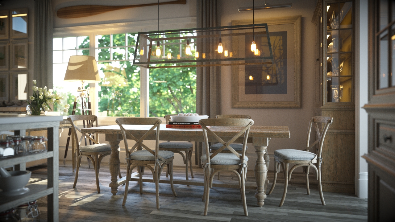

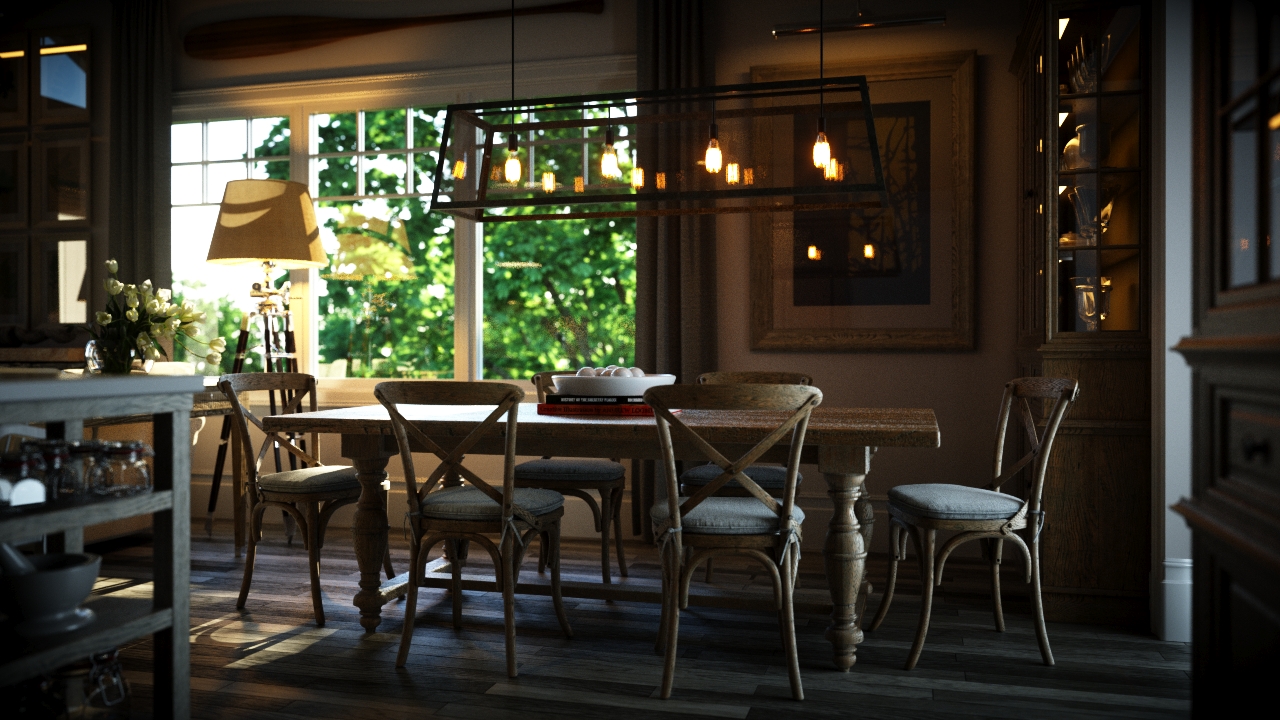

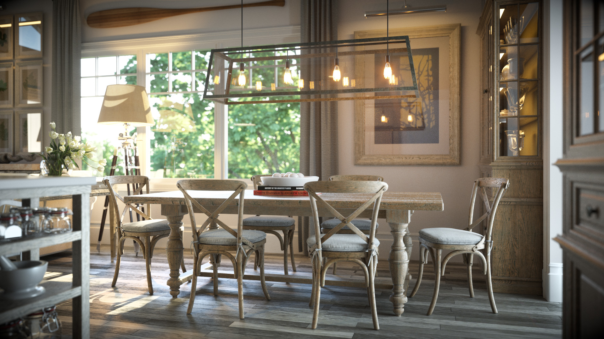

RobSteady - Comparison below. I kept the exposure and white balance identical to the original render to make comparison easier, but had to crank down the gamma to 0.8 on the Agfacolor (film) curves to compensate. The last one is Linear with the same gamma as the Agfacolor curves. The colours of my actual textures in photoshop are identical to how they appear in #1.
best,
O
