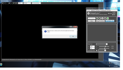

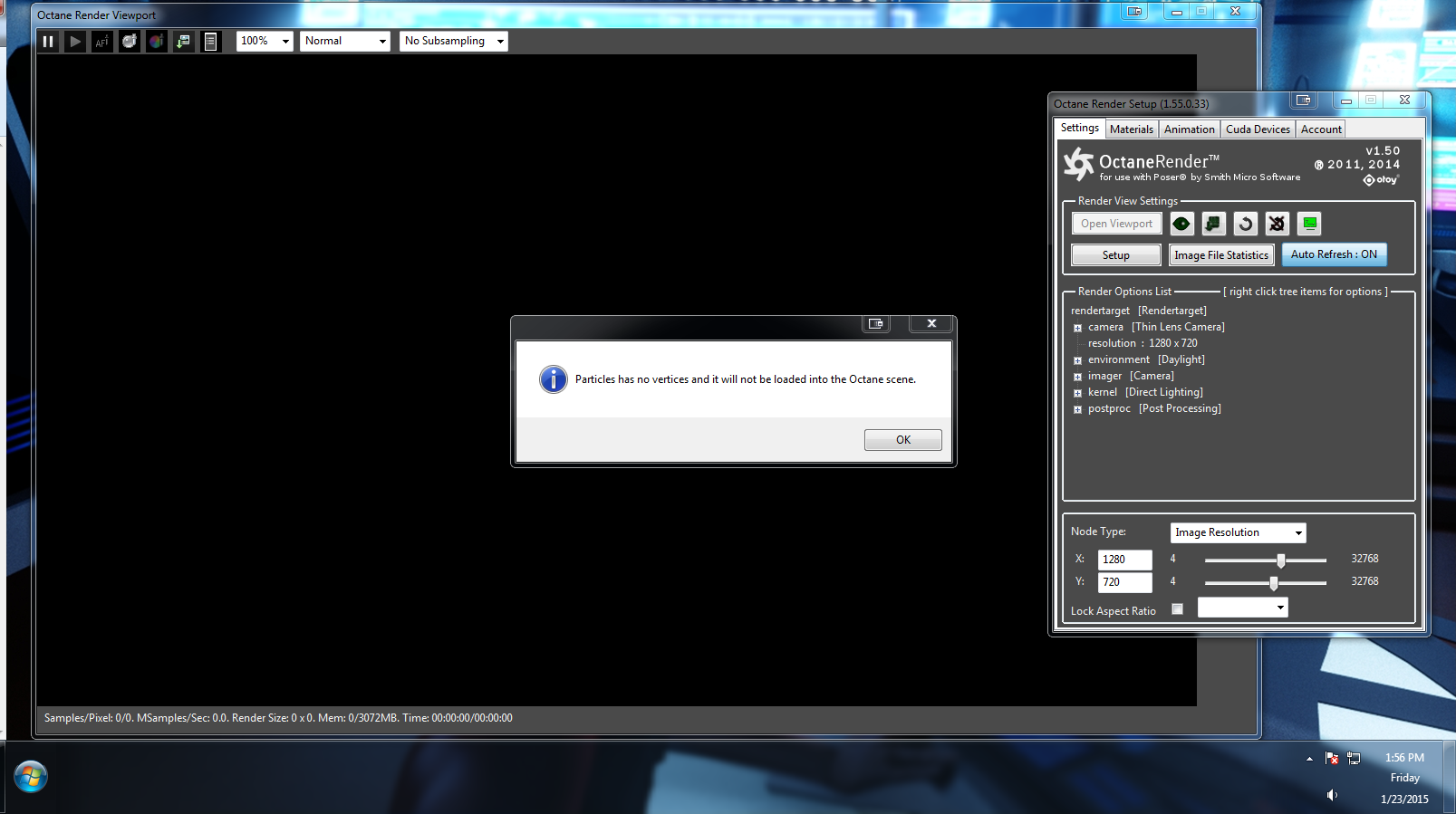

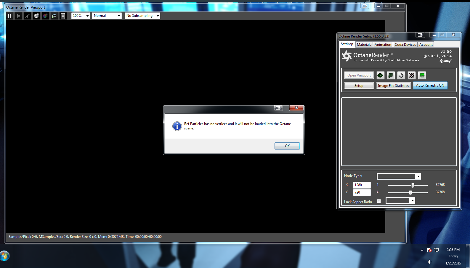

I get three errors in octane
but it load every thing just fine
Now the biggest problem is when rendering an animation. Now i have to enable refresh scene each frame so it well render the animation but I get those three errors at the start of each frame render. Now Its will render it out, I just have to hit okay button three times before octane render the next frame. Is there a way around this. these two tool for poser will work great together if you ask me.

They are not errors - they are information messages saying there is a problem with the geometry (ie. there are visible actors on a figure with no vertices). I would need to see the figure/prop in the Hierarchy window to determine the specific issue - however simply turning OFF visibility for Particles, References and Ref Particle may resolve the problem.I get three errors in octane

thanks you so much. Its workedface_off wrote:They are not errors - they are information messages saying there is a problem with the geometry (ie. there are visible actors on a figure with no vertices). I would need to see the figure/prop in the Hierarchy window to determine the specific issue - however simply turning OFF visibility for Particles, References and Ref Particle may resolve the problem.I get three errors in octane

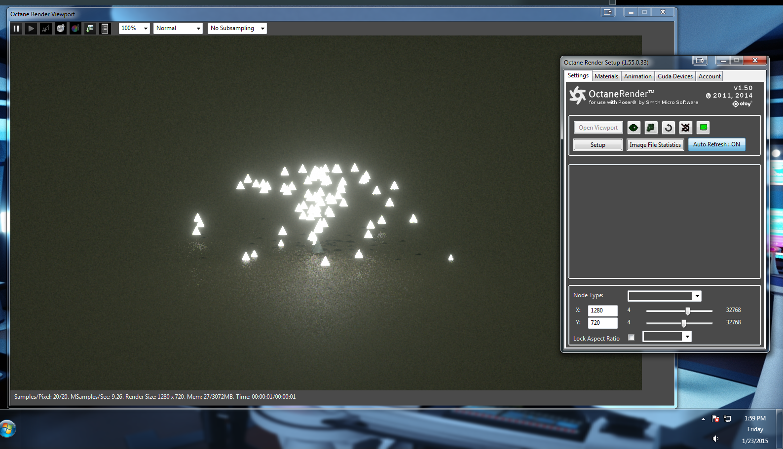

I have one more problem. When I render out a animation, octane only show the particles move when the Refresh scene each frame is selected. But I'm trying to apply an animated texture to a particle and the animated texture only works when the refresh geometry each frame is selected. And I can't selected both at the same time.face_off wrote:They are not errors - they are information messages saying there is a problem with the geometry (ie. there are visible actors on a figure with no vertices). I would need to see the figure/prop in the Hierarchy window to determine the specific issue - however simply turning OFF visibility for Particles, References and Ref Particle may resolve the problem.I get three errors in octane

I will fix this in the next release.I have one more problem. When I render out a animation, octane only show the particles move when the Refresh scene each frame is selected. But I'm trying to apply an animated texture to a particle and the animated texture only works when the refresh geometry each frame is selected. And I can't selected both at the same time.
