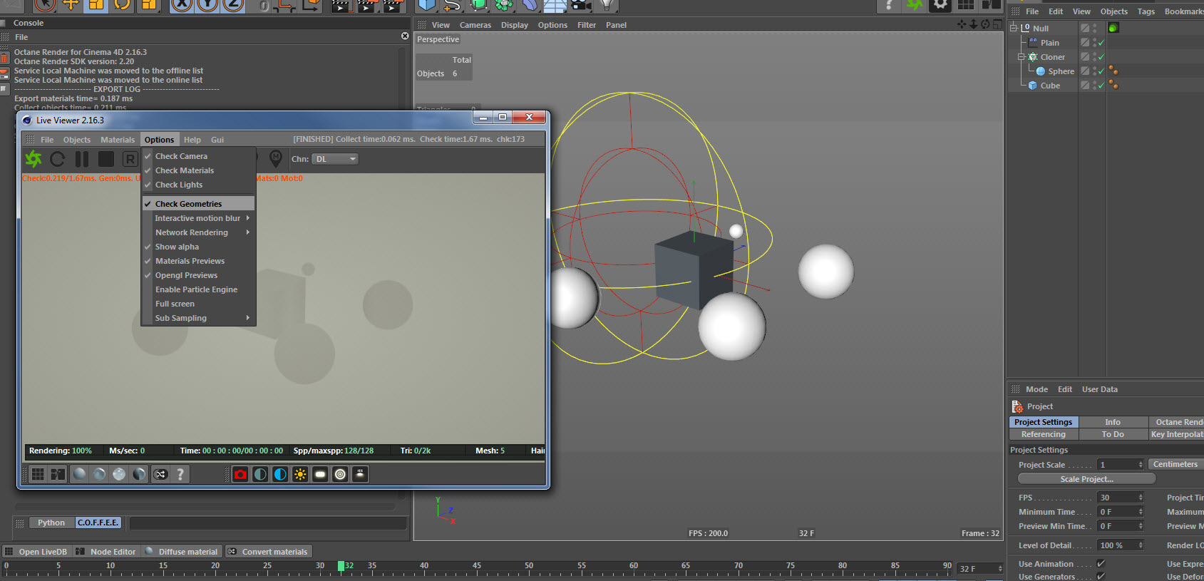

I've being trying to get my live viewer to update my animations, but I can't seem to get it to work.
What I'm missing here?
http://gyazo.com/fc2761ac20a2e26e1ee7e530bebf51a4
Scene: https://www.dropbox.com/s/9evpdwclr8dm1 ... t.c4d?dl=0
Fluffy
Posts: 11
Joined: Sat Jul 20, 2013 1:20 am
Works fine here. Make sure "Check Geometries" is enabled in the Live Viewer options.

That's really weird, because I can't get to update.
http://gyazo.com/427418e00a4d829262470f570fe3b6e8
It only works when i manual press the render button, what else could I be missing?
Posts: 16063
Location: Türkiye
There is no problem. See my image. what's your version, os?
EDIT: have you replaced and closed the opengl viewport?

Well tried a re install, updated octane, did not do anything.
But I found out what went wrong, I had my live view as a tab in the same window as the view port, which was not visible.
When I pulled out the live viewer, so that the view port and the live viewer were visible at the same time the updates work.
Didn't expect it to be that.
Posts: 16063
Location: Türkiye
coenbrasser wrote:Well tried a re install, updated octane, did not do anything.
yes, it requires a opengl viewport.
