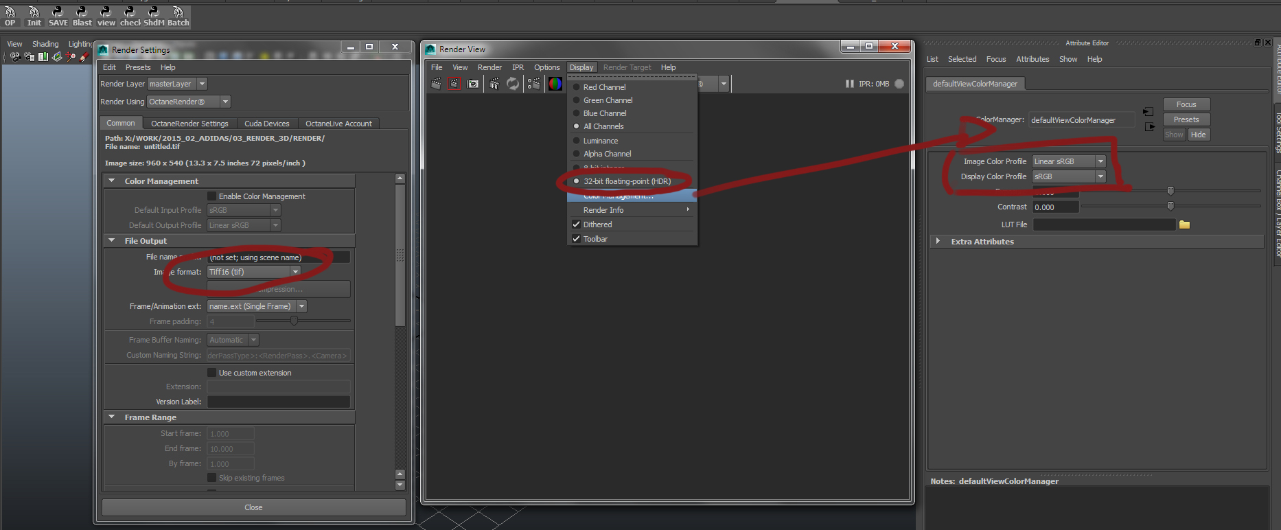

FYI here is our pipeline in our studio.
FIrst we set the output image type to Tiff16. Very important, it will make Maya workign in the right colorspace.
Then, in the renderview, from the display menu, colormanagement setting, we set the image color profile to LinearSrgb and the output color profile to Srgb.
THat way, the colorspace is linear and consistent throught the overall production.
Tell me if this is what you are looking for.

Cool, cheers.ciboulot wrote:Hi,
This solves the issue of adding an Exposure layer in Photoshop (whilst unchecking 'Tonemapping').
Oh, when you say 'color profile to Srgb', is this the 'Display Profile'?
so
Image Color Profile - Linear sRGB
Display Color Profile - sRGB
And I guess you're doing your highlight compression etc. in post?
An image is better than all explanations:

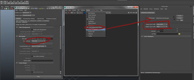

Nope, Maya 2014.
Maybe you didn't set your image type to Tiff16?
Laptop HP 8760w, I7, 16Go ram, Quadro fx3000m, Maya 2014, Octane 1.20a. Vimeo: http://vimeo.com/ciboulot/albums
Did you set the color management on in the render settings?
BEcause we always let that off
