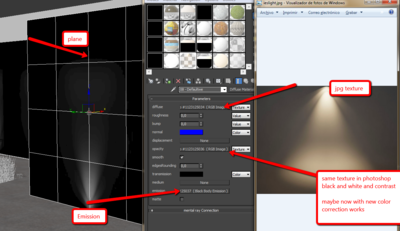

i need to create some reflecting light on a wall, but the light source need to be invisible, and only light on the wall - not on the ceiling.
i know how to add an hidden octane light, but i can't figure out how to avoid light on the ceiling.
any tips?
