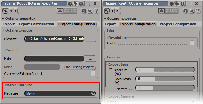

Changing the mesh size will change the aperture and focaldepth units too.

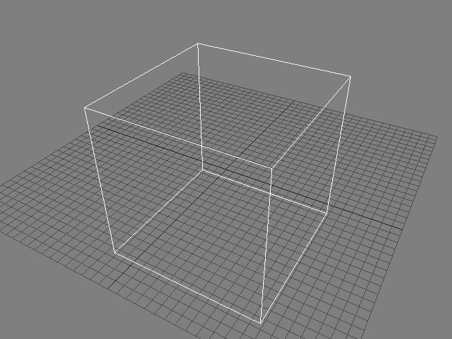

The use is simple, the cube in the image below is oversized, 20 SI-Units.
To export a rescaled version, change the native unit size from meters to decameters, the result should be 2m.

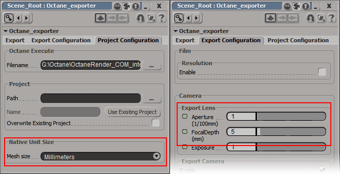

In this image, the cube is undersized, 0.2 SI-Units.
To export that, change the native size to decimeters.

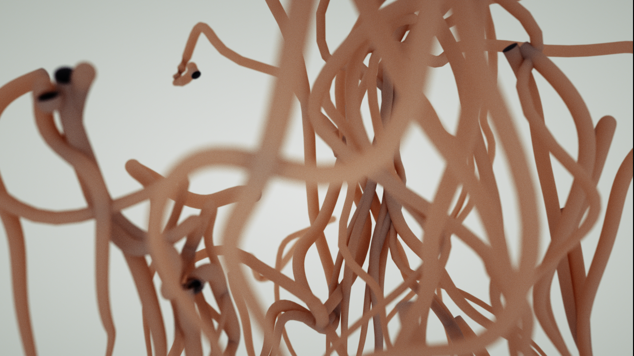

But i did some strands tests for the first time and i like what I'm seeing :D Very straightforward. Thanks to you i can render my graduation project entirely in Octane ;]
