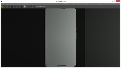

vmedium
Posts: 56
Joined: Fri Aug 15, 2014 8:29 pm
https://dl.dropboxusercontent.com/u/373 ... -forum.zip
Sure, no problem, thanks for your help!

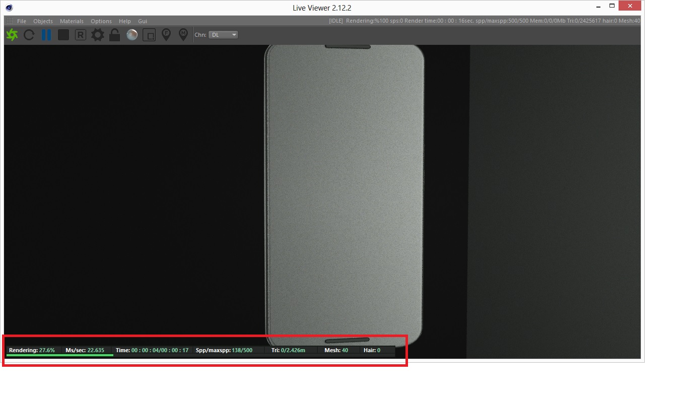

Hi, I think this is a bug in the title bar rendering status display. Please refer to the main status bar rather than the title (as seen in the attached image)
The only way I can reproduce your problem is this:
1) Open the live viewer and render out the full 500s/px (which is basically noise free). When this is finished the title bar changes to [FINISHED] Rendering:%100 .... 500/500
2) Hit refresh and then pause, which changes the title bar to [IDLE] Rendering %100 ... 500/500 despite the current samples/pixel.
Have you accidentally hit pause?
Chris.

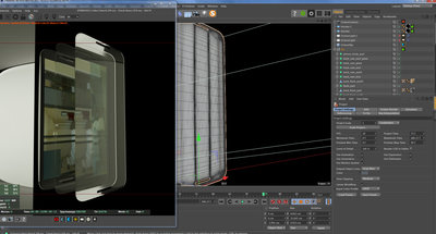

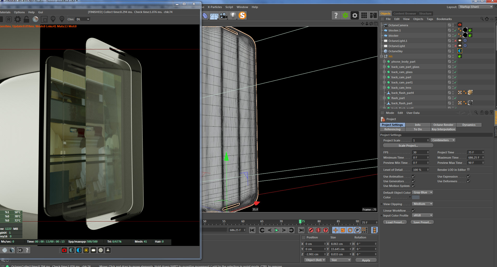

problem is related with materials and geometries. Also i had to copy/paste all to a clean scene. I have edited scene and front glass object. No need double surface, surfaces are very close. It will cleaned be on 500 maxsamples for PT or DL. Let's check the my revised scene.
Best,
Ahmet
