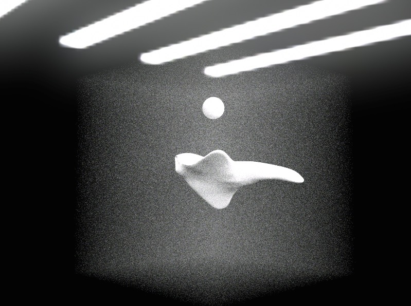

Here's a simple test I did. The sphere and the spaceship are within the fog material (the camera is outside it and the scene is lit by an HDRI) image. I would have expected there to have been shadows cast by the two objects through the fog from the light above but all I can see is that fuzzy box!

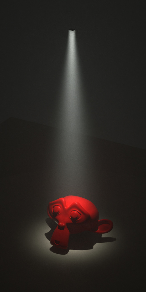

This is the right concept, but i think the lighting is the problem. It is comming from too many directions.
Try putting a small emitter plane with a tight IES light (spotlight) at the top, this means there will be a controlled beam of light hitting the fog which should be visible.
If there is too much light coming from too many angles, this is what you will get (just an area of fog).
See the attached .orbx (for standalone)

Hi Fooze
Thanks so much for the orbx file - it has helped a lot in trying to understand what you did. Here's an image thats starting to give the effect I'm looking for using your file. however theres a lot of grain so I think it will need some fine tuning. I also need to front-light the object too so that I can see the details so going to have to do a lot of experimentation. Anyway, its off to a good start
Thanks again
