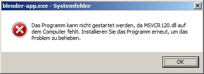

I had this Error:
Solution:
Download the Blender 2.72b Zipfile from blender.org and copy MSVCR120.dll, MSVCP120.dll and vcomp120.dll from that Zipfile to the same Folder of Blender Octane Edition.

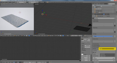

Tested a simple Scene with a Carpet (Particlesystem distributes a Carpetpatch over a Plane).
It works when I set the Emission Number to 10.
But when I set it to only (!) 100, then the hole Operationssystem gets very slow, almost frozen and it seems not to render (I did restart the Computer after >5 minuntes of waiting).
Here is the File:
Blender_Octane_Carpet_Test_01_291114.zip
(1.6 MiB) Downloaded 296 times
Basic question: Instancing is supported, right ?
Please tell me what I do wrong.

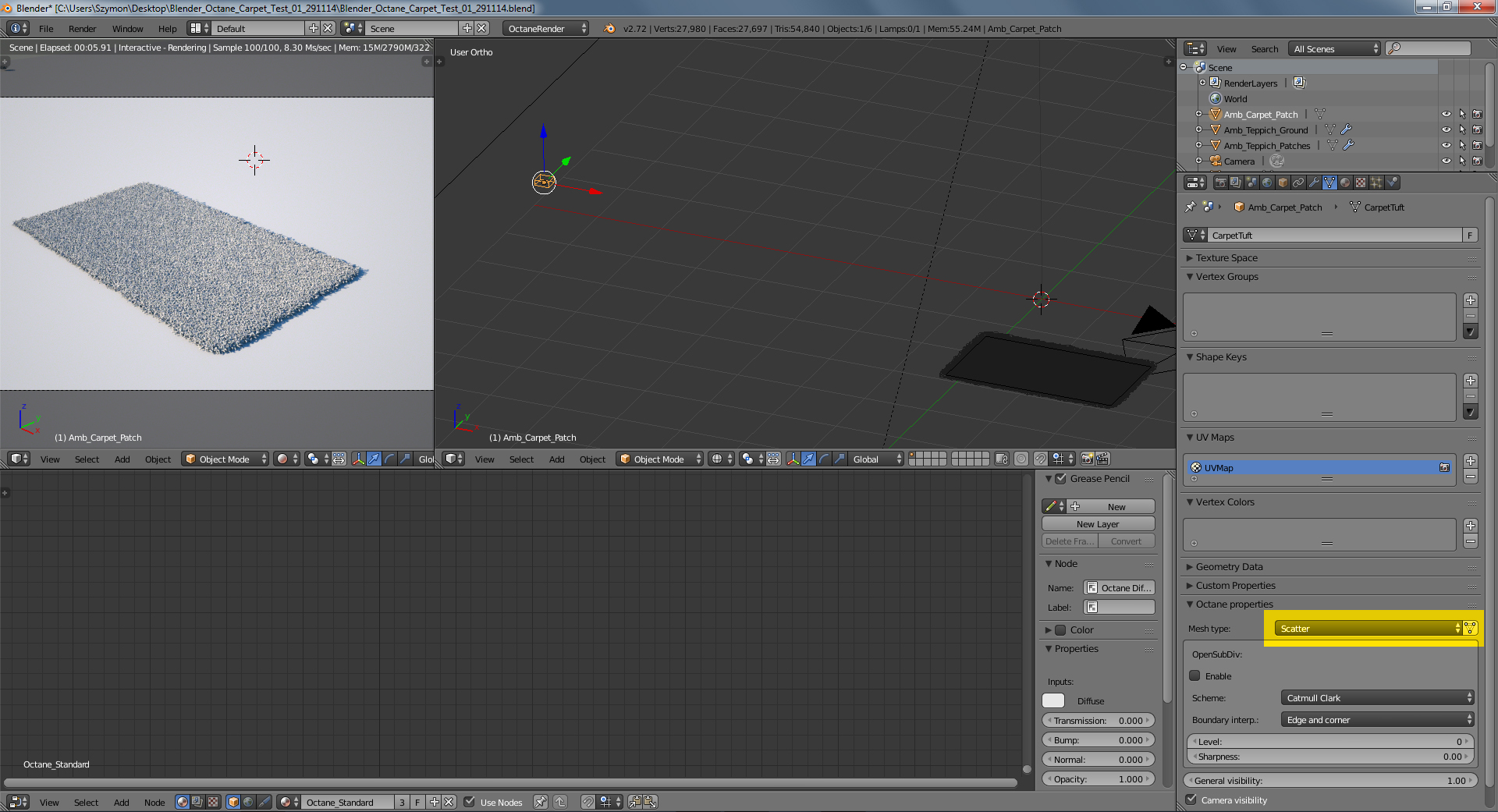

Alain wrote:Tested a simple Scene with a Carpet (Particlesystem distributes a Carpetpatch over a Plane).
Hi Alain,
Set your carpet patch mesh type to Scatter, as in the screenshot below.
carpet scatter
carpet scatter
Hope this helps

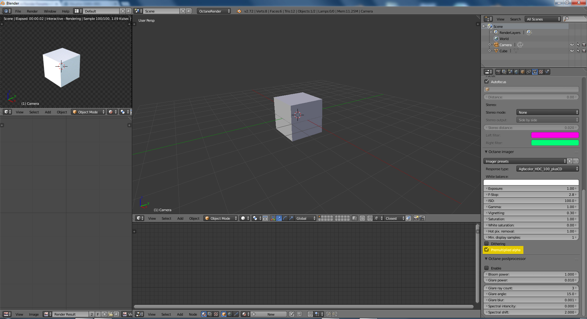

Hey! Just tryed to composite with alpha chanel (quick test).
As you can see in the rendered viewport there are white borders around my objects (not everywhere).
When saving the alpha-sequence and composite it in an other application, the white borders are there, too.
What can i do against that?

Hi dafassi,
Do you have Premultiplied alpha turned on?

No, thats what i was searching for.
Thank you for helping.
Wondering why this is under the camera menu- not under the render-settings?
Greets!
