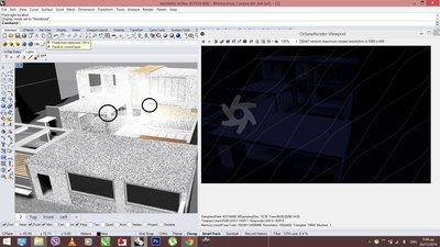

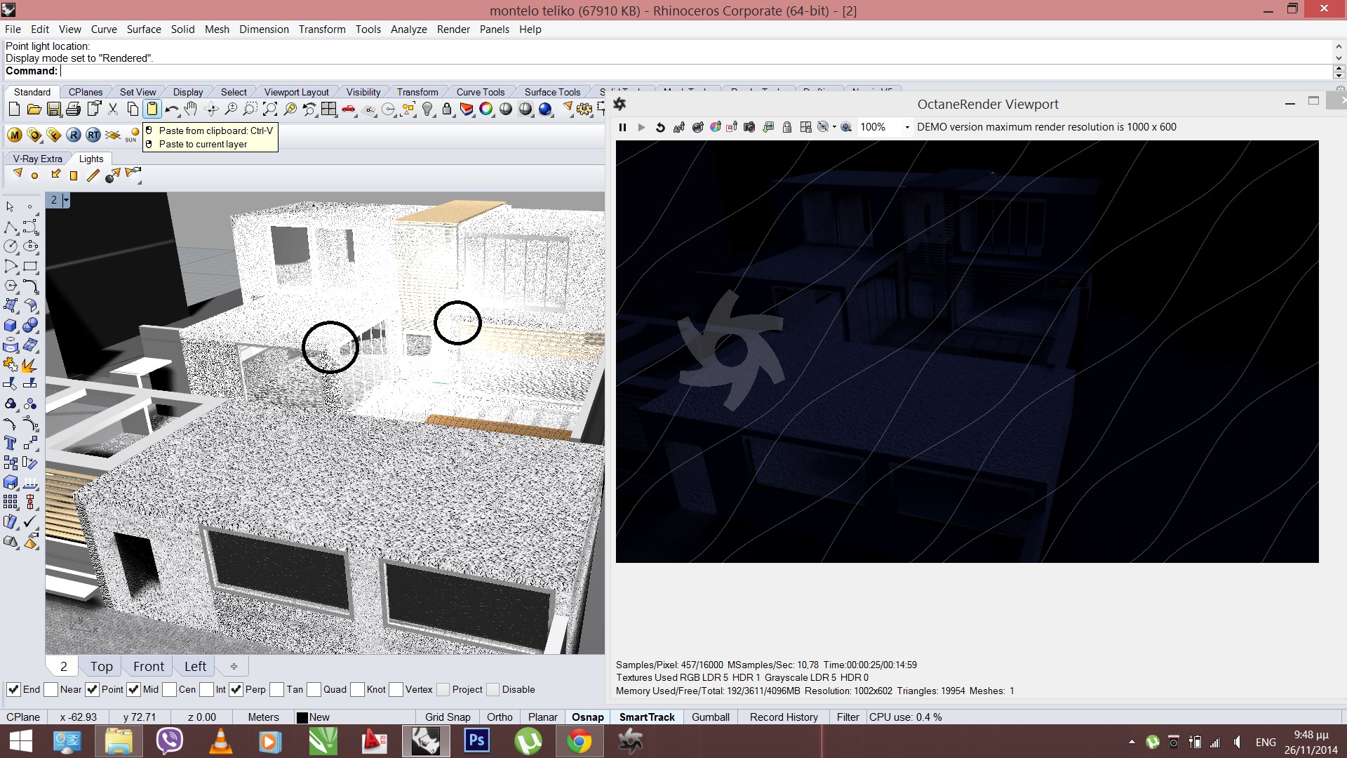

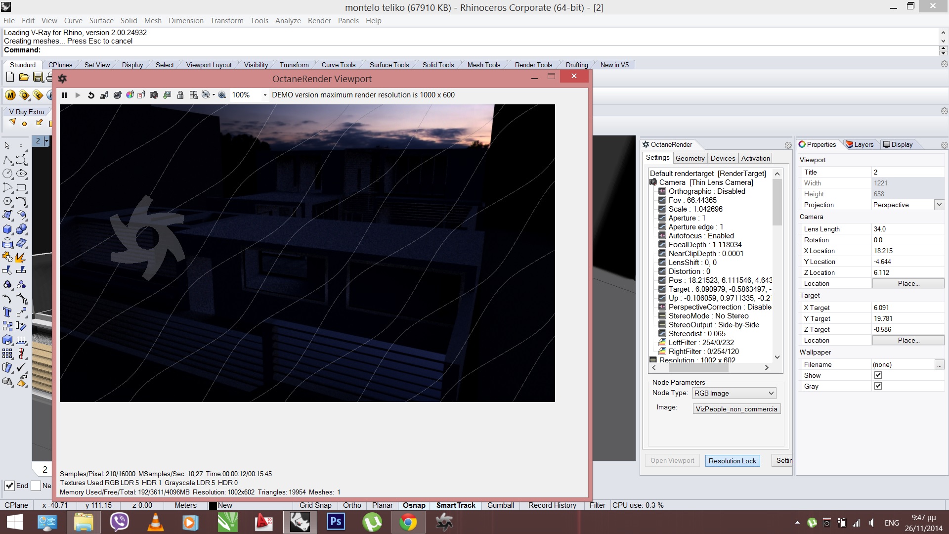

well here are some printscreens. in the 1 there are no lighs only the hdri. in 2 there are lights in the black cyrcles but they do not appear in render. i use demo version, is it the reason it does not work?

Hi - can you post a screenshot of the Material which is applied to the geometry in the black circles in 2 (ie. we need a screenshot of the emitter material)?

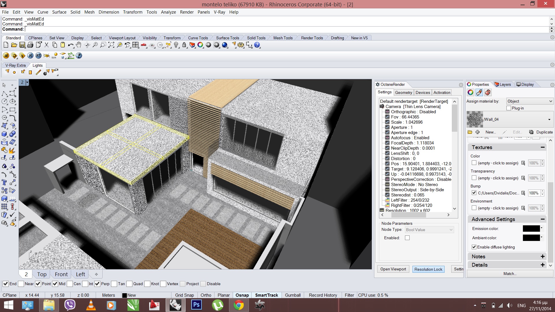

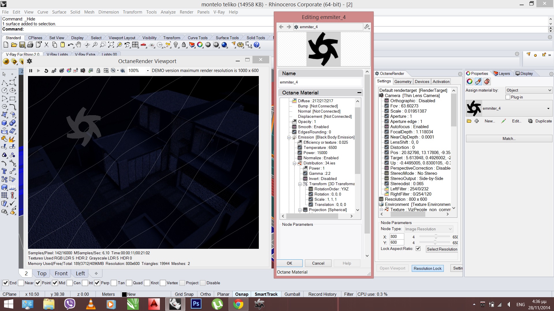

i don't know what the emmiter is. first time to hear it. if you can explain where to find i can for sure sent it to you. i could only find this in properties(image 1)
thanks a lot for your patience
Octane does not use "lights". It uses daylight, IBL or light emission from geometry. The plugin manual cover these in the following section: http://render.otoy.com/manuals/Rhino/?page_id=72.

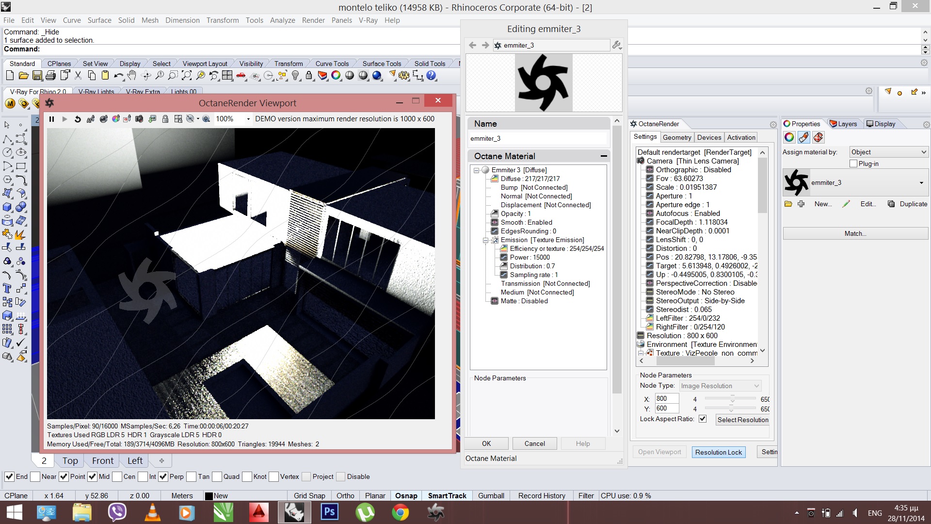

ok found it and i think i am getting somewhere, emmiter_3 works but sends light up while emmiter_4 is the same eith the manual. i think i have to make some more tests. thanks a lot for your help.. :D
