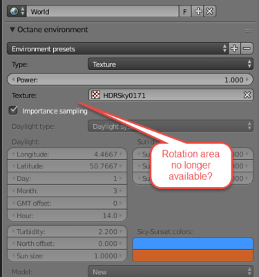

I have set up an HDR texture as the World - Environment presets - Texture image using an Octane Image Node and it is working. In the Octane Render for Blender manual (http://render.otoy.com/manuals/Blender/?page_id=77) it shows a "Rotation:" section just under the Texture display and instructs to use that to rotate the image - Quote "Rotation - If the environment is not in the correct directional orientation, it can be adjusted in real-time by using the Rotation parameter."
The issue is that I wish to rotate the image but the "Rotation" section is no longer available (please see screenshot below).
No_Rotation_Area
No_Rotation_Area
Can anyone suggest how I can rotate the Environment Texture?
Any advice is appreciated.

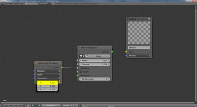

Use the Full Transform node, as in the screenshot below (X-Translation).

Many thanks!
