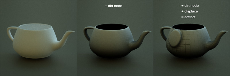

dirt node + displace = artifact
Andygraph3D
Posts: 268
Joined: Wed Mar 20, 2013 7:25 pm
Here a example with octane 2.04
Is it fixed in last release ?

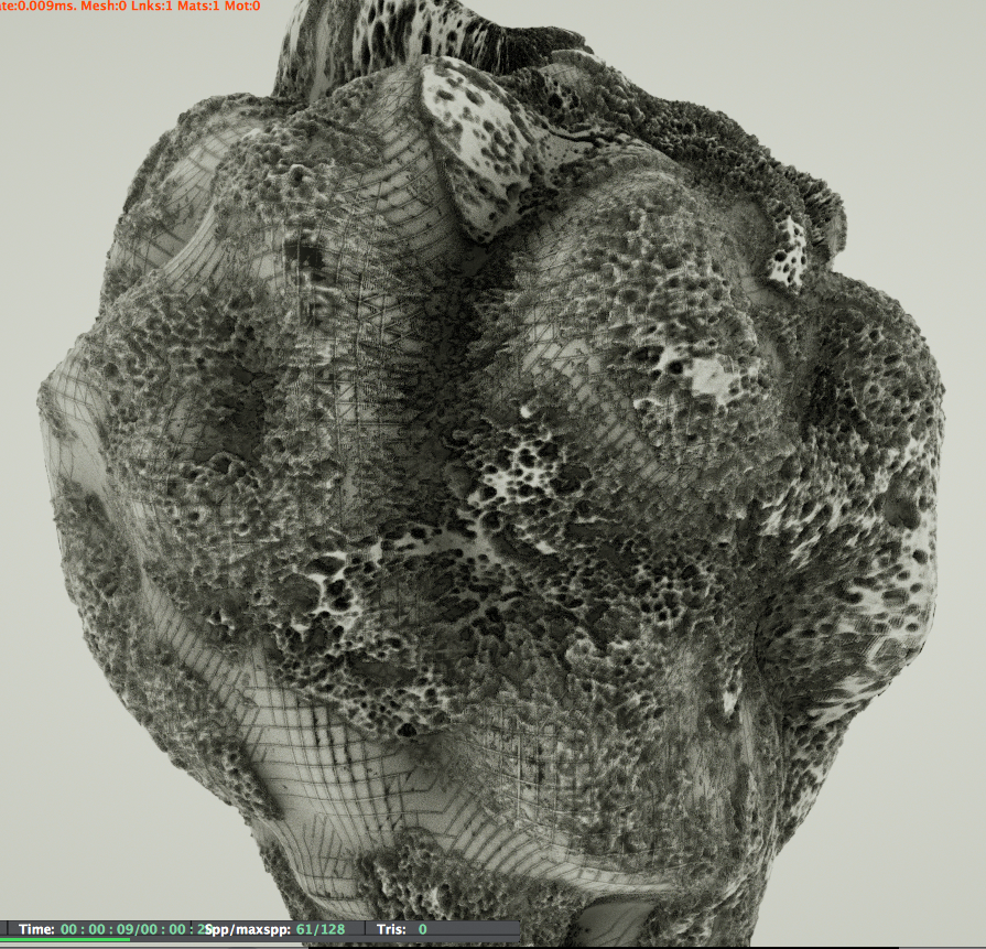

I have the same issue and would love for it to be fixed.
Here is my example.

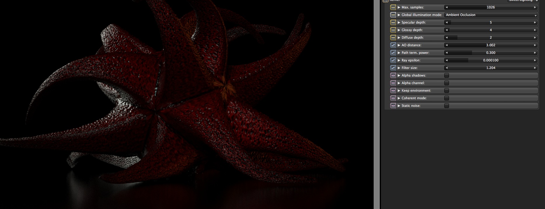

hi, have you tried to play with the ray epsilon value in the kernel node?
it dramatically change the dirt effect when displacement is active ;)

Posts: 10468
you need to augment it not reduce it ;)
here is an example:
at the default value

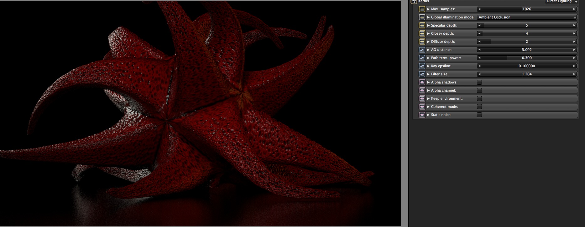

and with ray epsilon at 0.1
