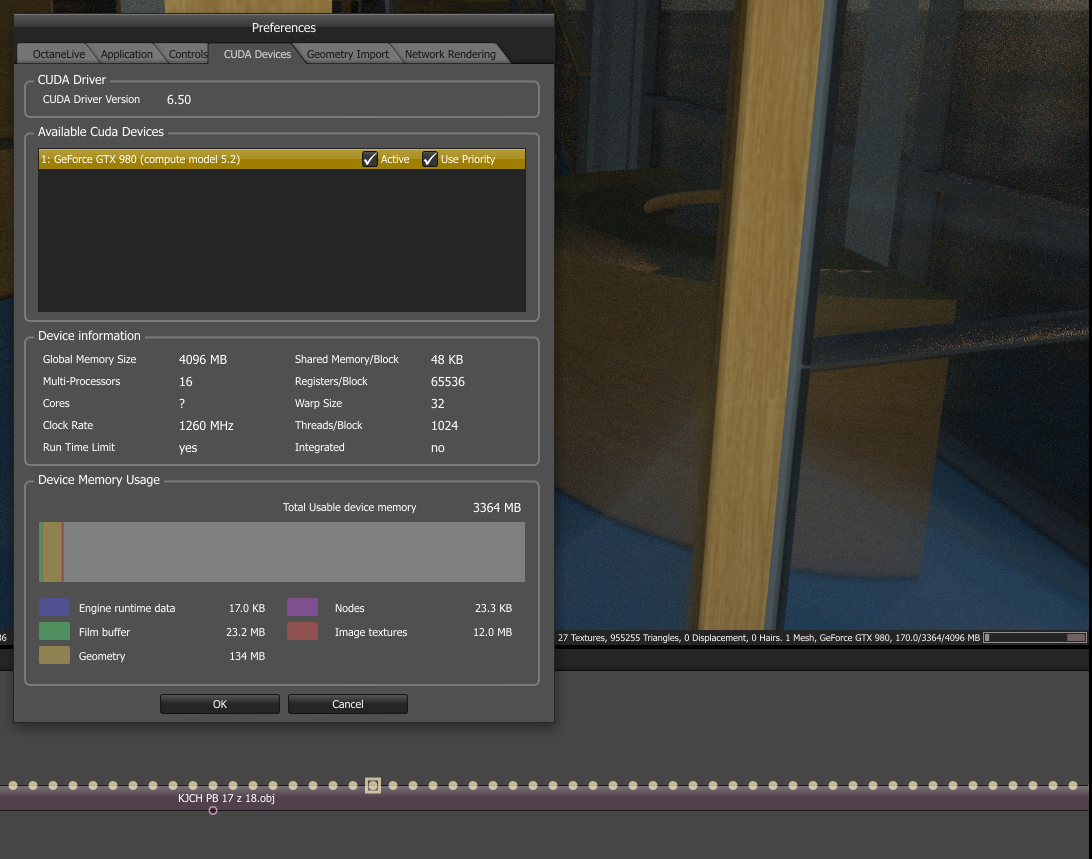

- I don't know what's up with that question mark, as attached, since I've got a brand new machine with the i7-4790K 4.0 GHZ 8 core or whatever you call it.

I do not know why it showes a question mark, but it is not about the CPU... The info is only about GPU.
(GPU has number of cudacores).

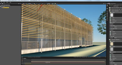

I don't know either that thing with the question mark, but what I've noticed today after importing to Octane a pretty big project from AC 18 is that Selecting Object layers Mode (O) is not working at all. Despite what I pick in render window it doesn't select a thing.
The reason of importing was that every time I tried to open Octane plugin in 3D window in ArchiCAD, AC crushed. 17 regular and 18 trial. as well. Just in this particular model.
Speaking about Marquee - I meant marquee selection in 2D opened in 3D window as a cut part of the model.
And what confused me was that although model was refreshing in Octane render window when rotated, it didn't show a marquee cut selection in 2D. And you're right you need to press Refresh geometry and materials button in Octane render Setup window.

Instead of the question mark, there should be shown the number of cores of the GPU.marek wrote: Hi,
I noticed you have a 980, and the developers are still working on coding for optimalization of the 900 serie.
Maybe that is the reason for the question mark. Anyway, that is not worrying is my guess.
At this moment Titan and 780 are the better choice, but probably soon the 900's will perform better
Can you show printscreens.. I do not understand exactly what you are trying to saymarek wrote: but what I've noticed today after importing to Octane a pretty big project from AC 18 is that Selecting Object layers Mode (O) is not working at all. Despite what I pick in render window it doesn't select a thing.
"Selecting Object layers Mode (O)"?
Did you first export your scene from Archicad to ocs, and then open it in the standalone?marek wrote: The reason of importing was that every time I tried to open Octane plugin in 3D window in ArchiCAD, AC crushed. 17 regular and 18 trial. as well. Just in this particular model.
Maybe face_off will be able to investigate your scene if you are having crashes with it.
If you want, you can also PM me and let me take a look at your scene.
You are welcomemarek wrote: Speaking about Marquee - I meant marquee selection in 2D opened in 3D window as a cut part of the model.

We have to hard-code the number of shader processors per SMM (multiprocessor) since there is no way to query this information from the system. We have done this for compute model 5.0 (GTX 750 (Ti)), but forgot to add it for compute model 5.2 (GTX 970/980). It will be fixed in the next release which should also bring some speedups for those GPUs.marek wrote: - I don't know what's up with that question mark, as attached, since I've got a brand new machine with the i7-4790K 4.0 GHZ 8 core or whatever you call it.
The good news is that this number is just for information purposes and not important for running the kernels.

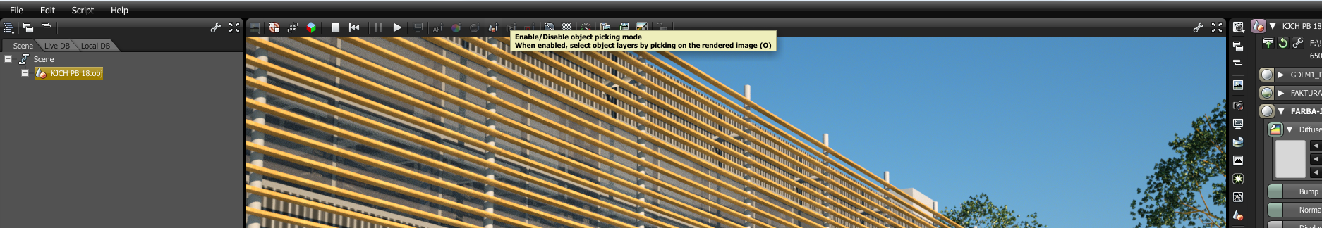

That cursor doesn't show up on Prnt Scr, but looks like the icon picked with the red arrow.Can you show printscreens.. I do not understand exactly what you are trying to say
I'm just not able to edit any texture imported with the OBJ file.

Well...I made a big deal by picking the wrong icon!!!
Just learning, I need some mercy, guys!
Supposed to be Material picking mode...
