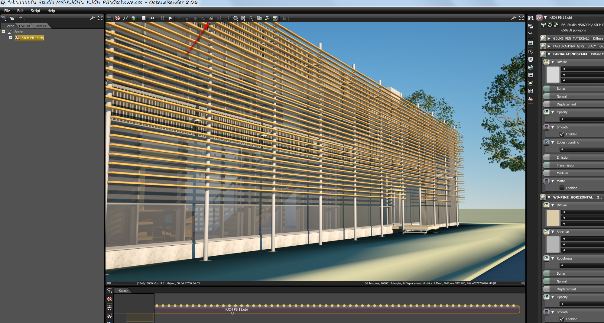

I don't know either that thing with the question mark, but what I've noticed today after importing to Octane a pretty big project from AC 18 is that Selecting Object layers Mode (O) is not working at all. Despite what I pick in render window it doesn't select a thing.
The reason of importing was that every time I tried to open Octane plugin in 3D window in ArchiCAD, AC crushed. 17 regular and 18 trial. as well. Just in this particular model.
Speaking about Marquee - I meant marquee selection in 2D opened in 3D window as a cut part of the model.
And what confused me was that although model was refreshing in Octane render window when rotated, it didn't show a marquee cut selection in 2D. And you're right you need to press Refresh geometry and materials button in Octane render Setup window.

Can you show printscreens.. I do not understand exactly what you are trying to say
"Selecting Object layers Mode (O)"?
That cursor doesn't show up on Prnt Scr, but looks like the icon picked with the red arrow.
I'm just not able to edit any texture imported with the OBJ file.

Well...I made a big deal by picking the wrong icon!!!
Just learning, I need some mercy, guys!
Supposed to be Material picking mode... :oops:
