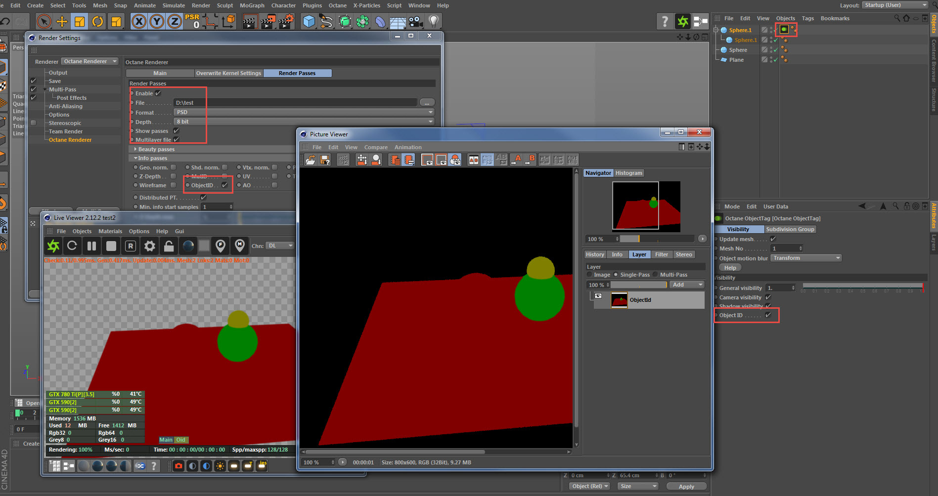

if you need a few object's pass, you can put a objecttag and select objectid. it will assign random colors to each one. But you should read my last message.

no, only disabled the c4d's passes even object buffer. It's possible to use Octane's new pass system. But objectid pass is working with random colors. we will change this to similar way of c4d. See the image how works.
passes.zip
(43.06 KiB) Downloaded 188 times

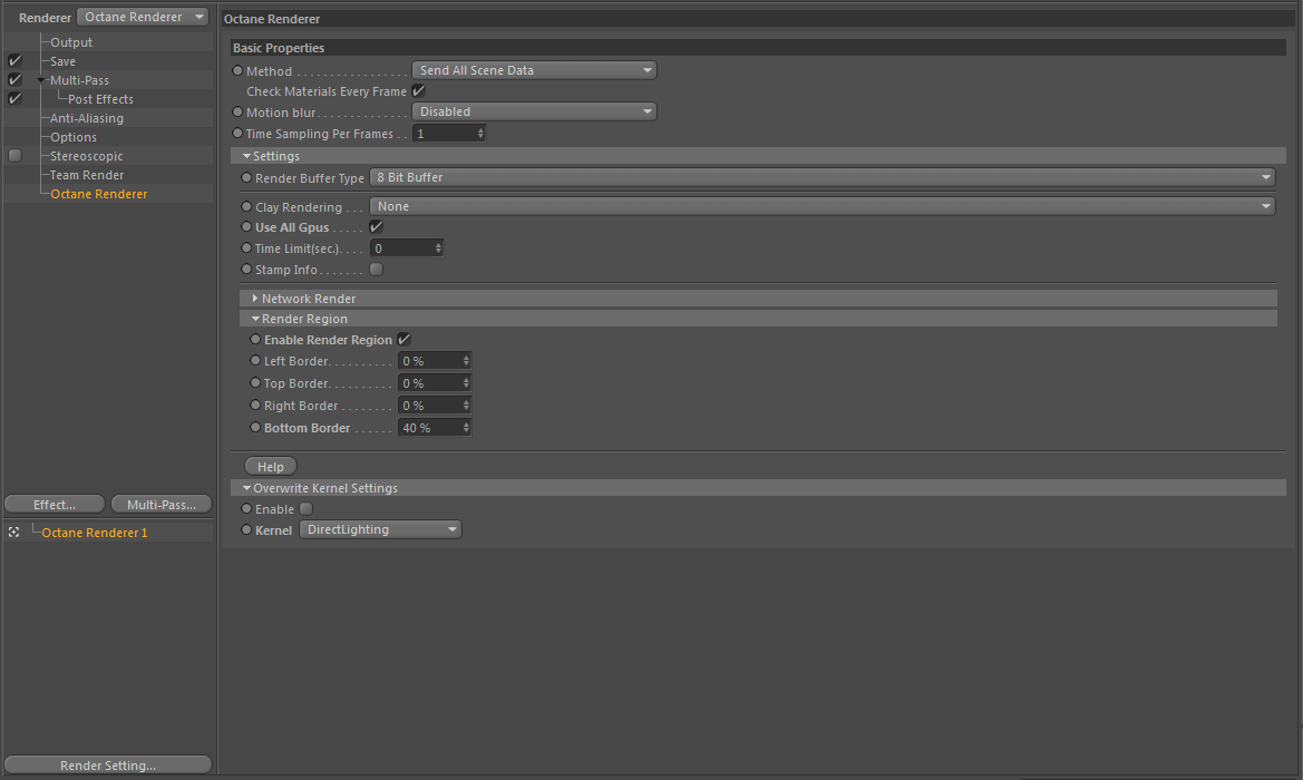

i don't seem to have the same plugin version as you or something, i can't see the render passes tab :(

Posts: 16066
Location: Türkiye
you should see that in top topics of this forum.
