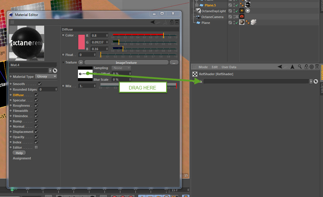

i'm sorry but i can't figure out how to link the refshader to the imagetexture... tried opening two windows and clicking, tried dragging, but no success

You can drag as in image. Also you can use alpha with changing the "Type" parameter to alpha. You may need to create a second imagetexture accordingly to your image's content.

it works! thanks very much :)
