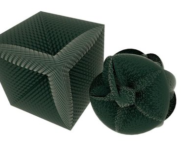

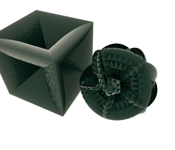

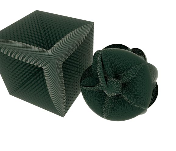

Maybe an explanation: i've made a quick test with a noise inside the C4D effect > Normalizer and the result give this kind of curious triangles inverted normal map with a sphere but not with a cube. With a normal map bitmap, it works fine on both.
Not sure but maybe it'll help you.

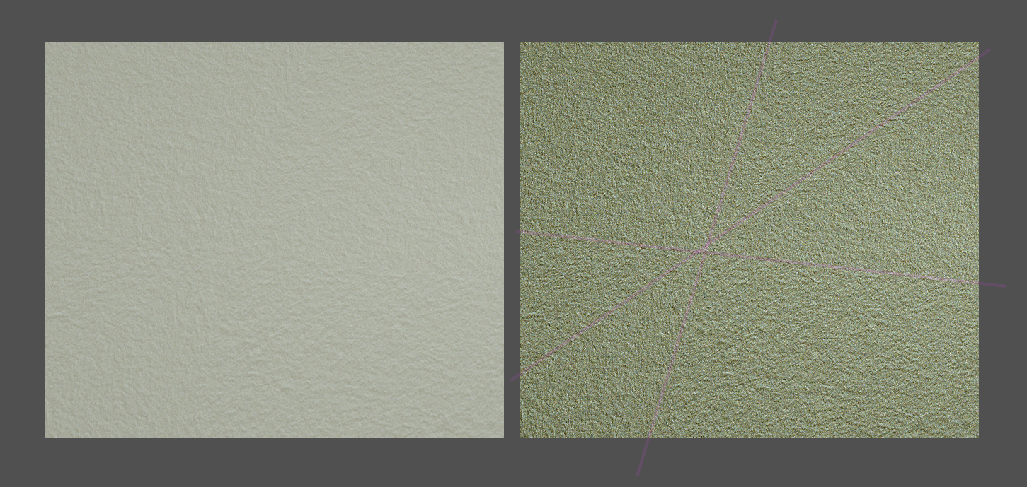

It would be great if the two could co exist as it would speed things up. I've attached a still of the issue I was having for reference. I've graded the one on the right and put rough wireframe over so you can see where the breaks in the normal map are occurring.
