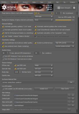

I just reinstalled everything. I have the licence and everything. When I load up a G2F model DAZ crashes to the desktop. If I disable the plugin, everything works.
The crash however only happens if I load up a character model. If I just load up a scene model, everything is fine. The crash happens when Octane loads up the materials
Here is a SS of my preferences
