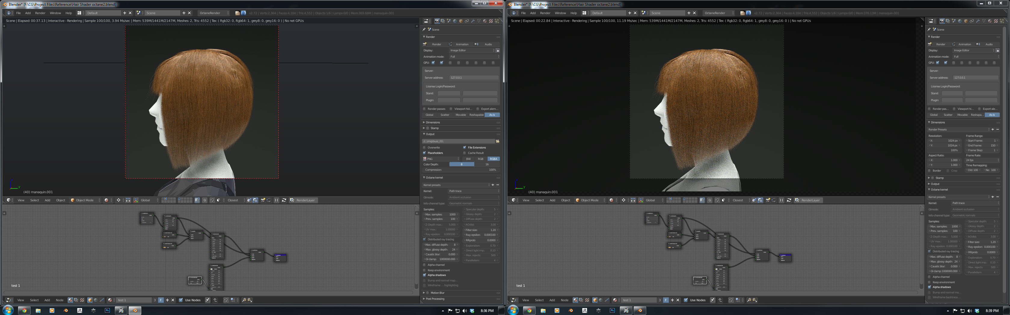

The hair works fine
Rajiv Mudgal
Film Maker and VFX Creative Director at DarkWhite Productions
Win 10 64 |3X Nvidia Titan | i7 5820k | 32GB
