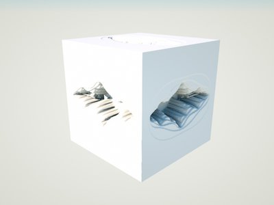

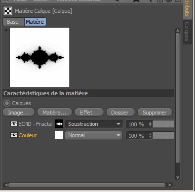

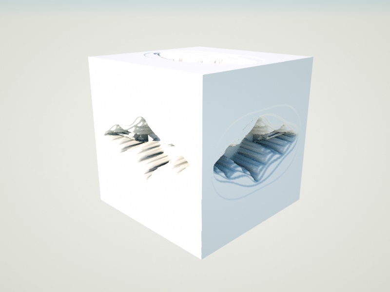

Just use layer and substract ! and set shift with same value in displacement ...

@LudovicRouy: As far as i know, EC4D - Fractal is a procedural shader from Biomekk. It's not a bitmap file.
Procedural shaders are converted on the fly into bitmaps by the Octane plugin with the function into Settings (Settings tab > C4D shaders (2D)), that's why your solution is working. If you try the same solution by replacing the EC4D - Fractal with an external bitmap file (like a .tif or .jpg), it will not work.

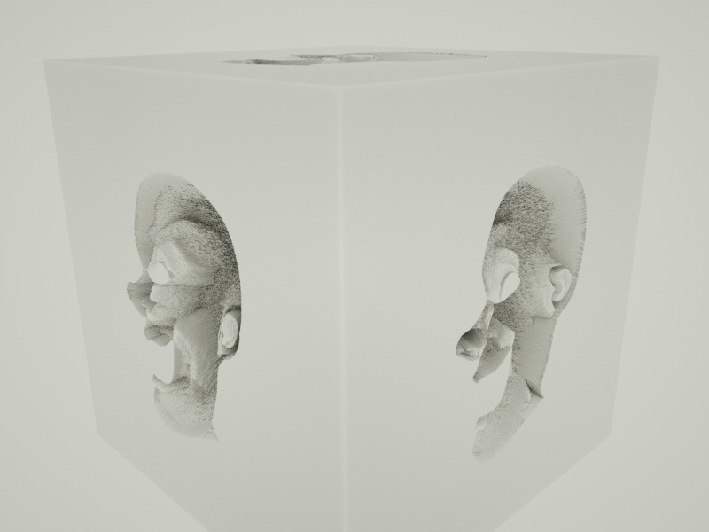

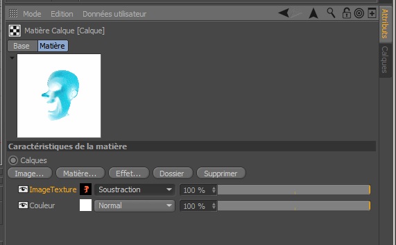

So just put an Octane image texture as substract layer and it works !

Great idea! ;)
I had never tested to add an Octane ImageTexture node inside a C4D layer. It works really fine. Thanks for the tips!
