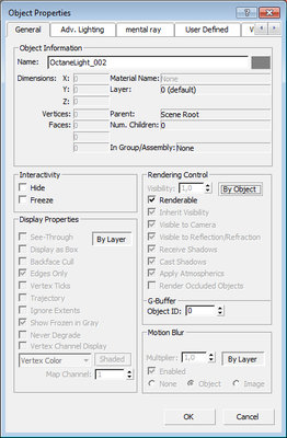

Did you try this..
Leave visible option on in lights modifier panel.
But turn off visible to Camera checkbox in octane light's object properties.
You can see the reflection of the light but not visible to camera.
it works for me...
it works for me...

Those options are greyed out to me as well since last release(s).
I used to use the Visibility parameter sometimes, too.
update:
My mistake, the Visibility parameter is avaiable if you use a Plane with an emitter material.
