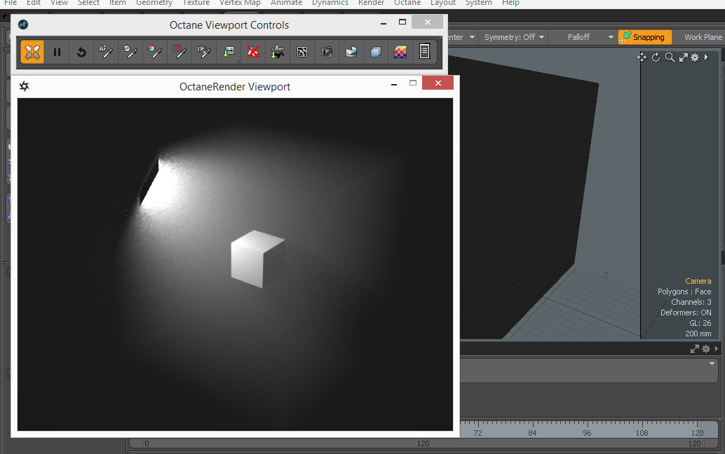

I have attached a Modo sample scene.
Camera must be out of the "fog box" ("Cube 2" in this case). The emitter is inside (but probably not mandatory).
Set hotpixel to 0 and caustic blur to 1. Use Path Tracing.
The fog material probably needs Scatter < Absorption. Set Reflection as 0 (black), Transmission as 1 (white), Index 0.
Paul

Got it. Thanks. I had to adjust a few things but copied your material exactly. Thanks!!
