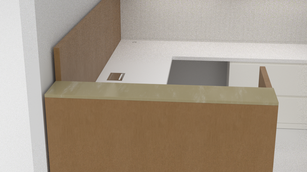

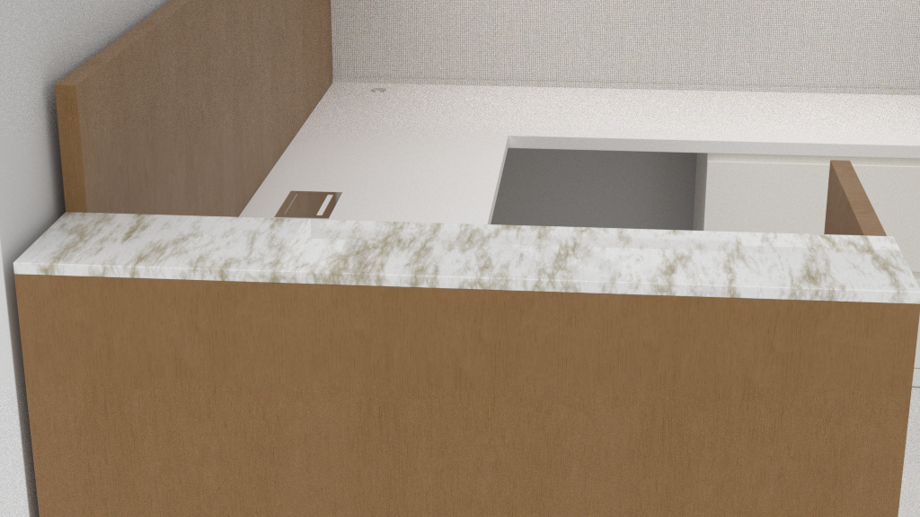

I just opened a scene where I used the marble procedural from 2.06 to 2.1.
Were there changes in procedurals or is this a bug?
I attached the material.
Changes in procedurals for 2.1?

Hi Kavorka,
We can reproduce this, so it's not just you. There were changes to the turbulence generated texture and the marble is based of this.
(This change was unintended so I think it will be put back to normal in future releases).
In the mean time you can make them the same by increasing the variance.
Chris.
