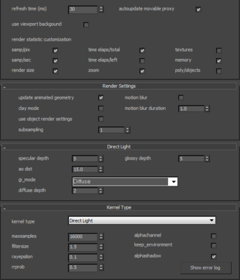

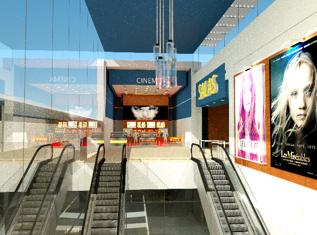

I left this image rendering all night and still it did not get rid of the fireflies. Here is the image and the kernel settings. I am using a lot of mesh lights (blackbody emitters) Is that not recomended? should I switch all those lights to Octane lights?

When You're using black body emitter for mesh lights, need to make sure the geometry is optimised to have least amount of faces - single plane/quad is the best option =)
There are other things to take into consideration too, as Your Ff might be caused not only by lights, but also specular material, light coverage etc..

Why not use PT kernel instead and use GI clamp. It should help a lot in this case.

Try to set Hotpixel removal to 0,5.
