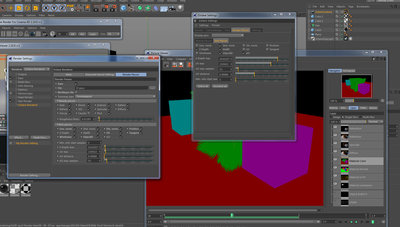

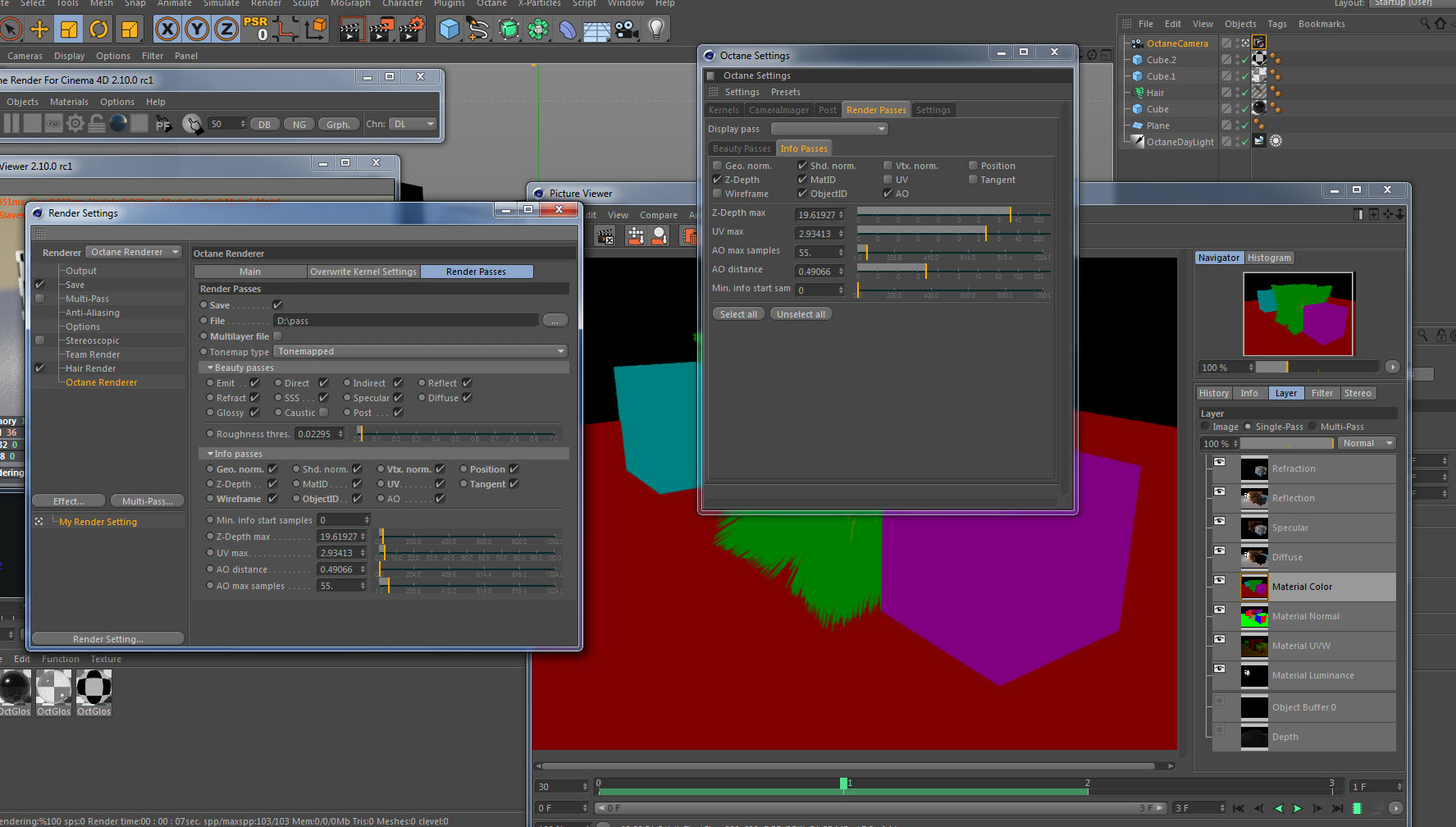

Second big feature is Render Passes.
This is still not completed and under development. It will be updated soon. So user feedbacks are important currently. In this version, i have integrated some new Render Passes functionality. Currently we are bypassing C4D's Multi-pass interface and will use new gui. There is no need to add Render Passes from render settings. Only you can select the desired passes from Octane Settings. But please don't forget this is uncompleted section. To use or not is under your risk. This version is only a test and previewing release.

The only thing that didn't work correctly was multi pass layers
in Picture Viewer. Some layers didn't show up in Layers Tab (Picture Viewer)

thanks centilmens! as krzychuc4d says that I cannot show some layers in picture viewer. this is limited by C4D's current layers. but plugin saves all layers to a multilayered psd or as separated files. this part is not finished yet. second, info layers not shows dof and motion blur. I think that should be fixed.

One thing I noticed from first tests is, that the
objectID is black/white in PictureViewer, but when I open
the Multipass-File in PSD, the objectID pass is colored like the
material-ID-pass.
I think object ID should be pure black and white.
Btw. anyone knows for what or how to use VertexNormal, UV, GeoNormal and ShadingNormal passes?
thanks
Mike
fantastic!
Thanks very much!
material-ID-pass.

As i said that i can't change some layer buffers as ObjectID. So this is the main reason to develop new section and system for passes. But you may see correct output in saved images. Octane does colored objectIDs since beginning. Also many renderers does. Anyway we will add user controls to set colors.
