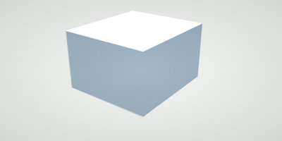

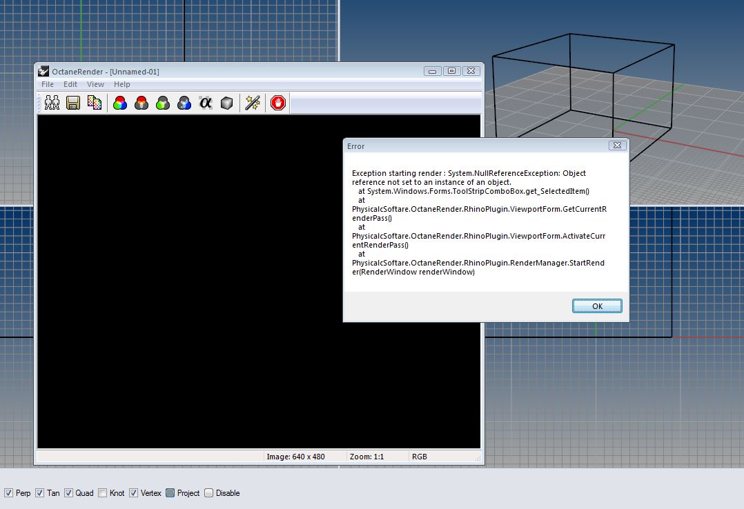

Hi Paul,
Getting an error using the 'Render' command (as opposed to opening the OctaneRender viewport) - see attached image. It instead causes the viewport to stop responding (I assume related issue). Thus !_RecordAnimation doesn't currently work unless using viewport geometry (ie. no scripted or bongo animations) amongst other things.
See image:

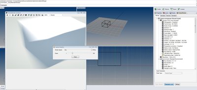

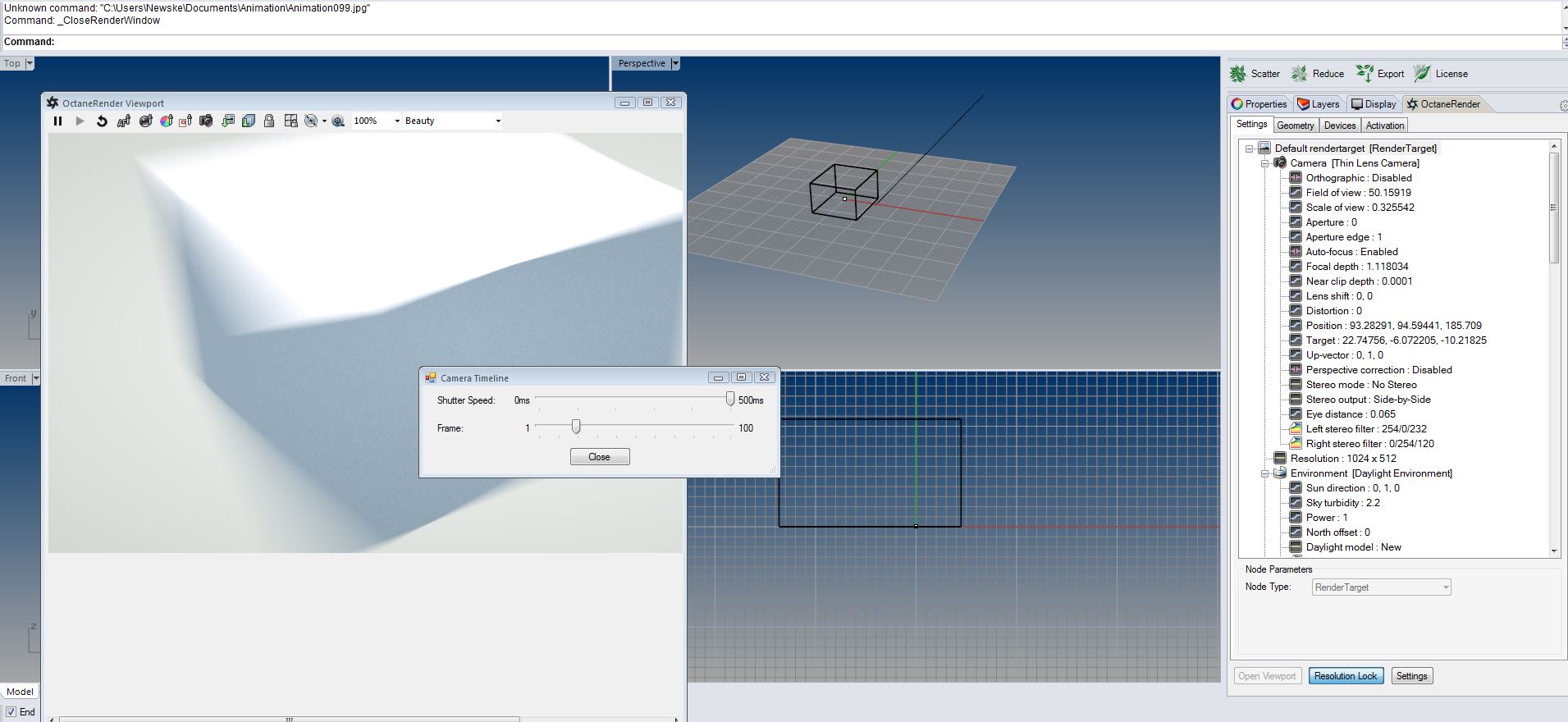

Also, having a little bit of issue with camera motion blur - I'm not sure if I'm using it properly or not. My process was:
  • - Set path animation target and camera
    - Open OctaneRender viewport
    - Press the animation button in OctaneRender. The animation the runs through and prints a whole string of commands to Rhino's console (is this intentional? _ViewFrameNumber?).
    - Close the animation window
    - Type !_RecordAnimation, save files
I attached screenshots demonstrating this - the 'expected' result (500ms shutter speed) and the rendered outcome. Note that due to the issue listed above this is 'using render viewport geometry' to record the animation.
And lastly, just wondering if there's any way camera motion blur can respond to the camera motion paths of Bongo, and also (less importantly) whether there was any news on the front of object motion blur with Bongo, as IIRC it was discussed a little while ago.
Cam
