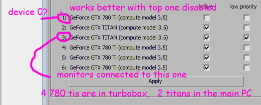

Seems like if I disable the very top card 780TI in octane setting (Which is the bottom card in my netstor turbo box, that has 4 gtx 780TIs) it works more reliable.
Is my device 0 is the very top card in octane settings? I guess the card itself that happens to be device 0 is bad? Or once I disable the top one octane chooses another card as device 0 or nvidia decides?
Thank you

Can't say for sure regarding device numbers, but looks like there is some problem with one of your gpus.

Strange thing that If I set the top card with Low Priority mode it works fine. But disabling priority mode gives me cuda error 700
Karba
Posts: 2300
coilbook wrote:Strange thing that If I set the top card with Low Priority mode it works fine. But disabling priority mode gives me cuda error 700
It is expected. The top card has some hardware problems and can't run at full load.
The device may be overheating, or doesn't have enough power or has some manufacture defects.
