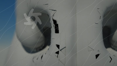

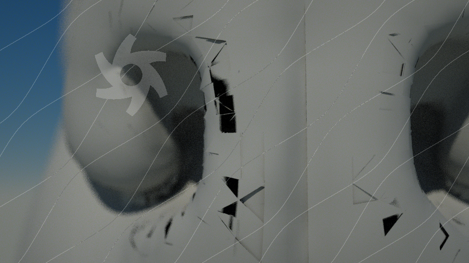

does anyone know what might be going on here. When I add a displacement map, it displays weird triangulation artifacts.

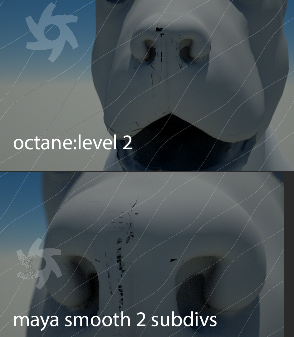

i've made a few examples.

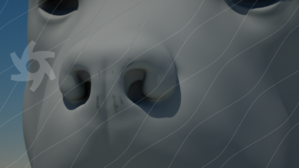

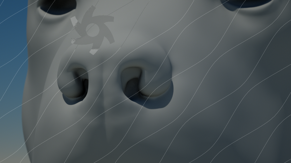

Ok, so this time I put the octane:level up to 4! It seemed to improve it a little bit. You can still see the tiny patches of distorted triangles.
I don't know what else to do to get rid of the black patches. I will upload my scene as well.

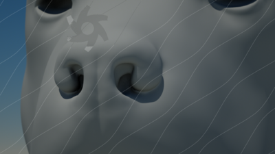

I think I finally fixed it. Last thing was Rayepsilon setting. Changed it to .0200
