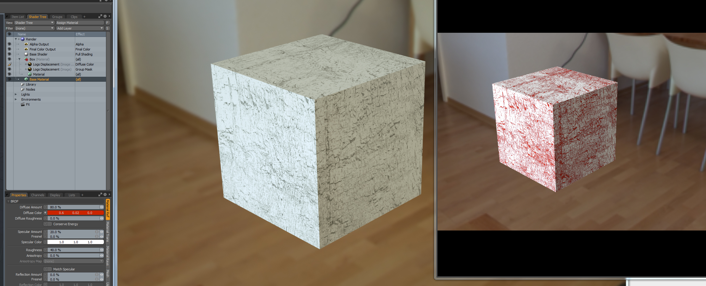

Hopefully this screen shot explains it. Pretty basic, the group mask is letting the bottom material come through. Can see octane just keeps that same diffuse, while modo is allowing the red to come through.
Win 10, Threadripper Pro, Dual 3090s
face_off
Posts: 15757
Location: Adelaide, Australia
The group mask situation you describe above can be manually created as per below. Automatic creation might be able to be done, however I'm unsure how the plugin would know the background color (ie. the red in this case). I will see what can be done.

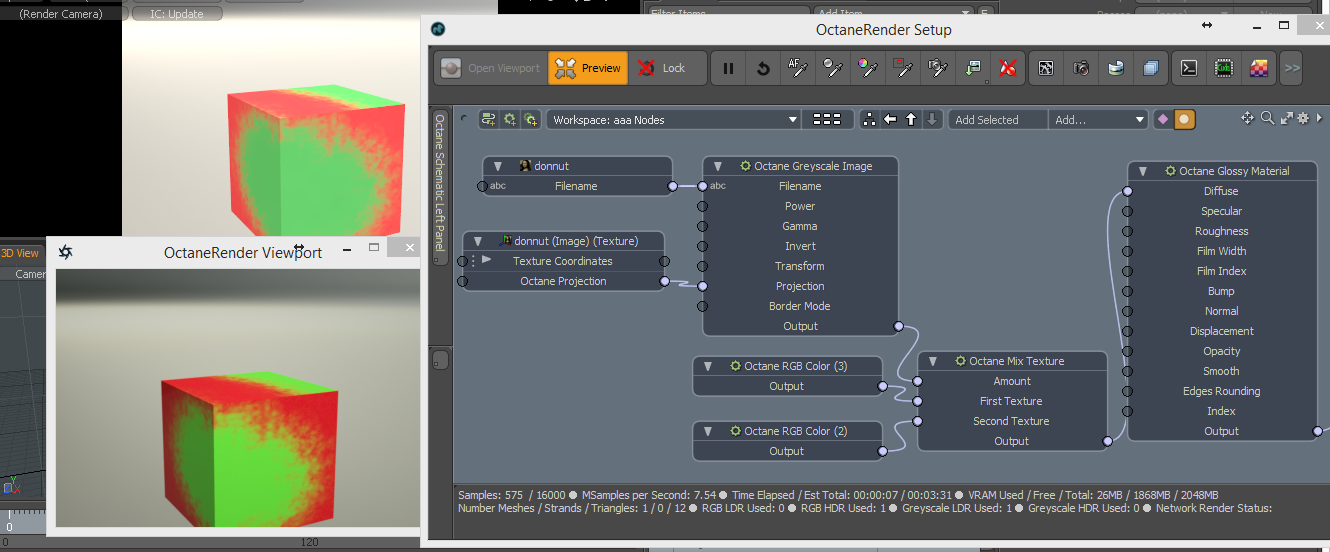

dancouto
Posts: 8
Joined: Wed Sep 09, 2015 7:17 pm
You can chain as many Mix Textures as you want, using the Group Mask image as the Amount. It works really well. I just did a product shot that uses 2 Mix Textures like this.
