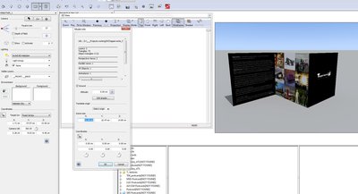

Just trying one thing between artlantis and octane.
I saved the whole artlantis scene as OBJ and import in Octane using geometry - mesh.
But after that, I just got lost and there is noting really happening.
Any idea?
Thanks.

Hi Scottie,

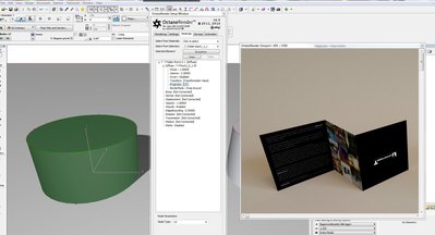

I have exported an Artlantis scene to an OBj and imported it in Archicad plugin.
The UV textures are exported, but imported mirrored in the plugsin ?
When I re-open the OBj in Artlantis the texturemaps are mirrored too, so it is not a problem of the plugin, but the way Artlanti exports it to OBJ.
I am using Artlantis 4 by the way... maybe it is improved in artlantis 5?
In the plugin I have to set the proxy scale to 1% to get the right size.
greetz,
4090+3089ti & Quad 1080ti
http://www.tapperworks.com
rappet
Posts: 1962
Joined: Fri Apr 06, 2012 3:57 pm
Location: The Netherlands
Hi Scottie,

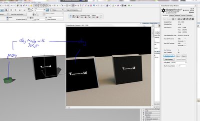

Ok, maybe the scene I started with in ATL had something strange with UV or something.. so to be sure I started a scene from scratch.

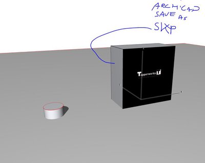

I have made a scene 100x50cm and heigth 100cm adn made a material to give it a texture front and back.

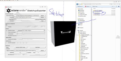

Then I saved only that object to SKPs.
Then I opened Sketchup and used the Octane exporter to save it as an OBJ.
(When saving from Archicad directly to an OBJ, the UV is not good, that's why I use Skecthup as inbetween)

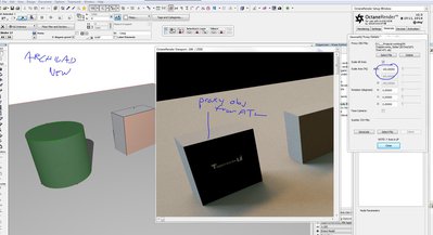

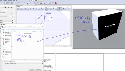

Then I open the OBJ in Artlantis and export it again to a new OBJ.
So Now I have one OBJ from Sketchup and one from Artlantis
In sefperately Archicad files I used the OBJ as a proxy with scale 100% and they are both fine.
So my conclusion is taht when having the scene UV-ed properly it is possible to have a good export from Artlantis to OBj to be used as correct proxy.
greetz,
