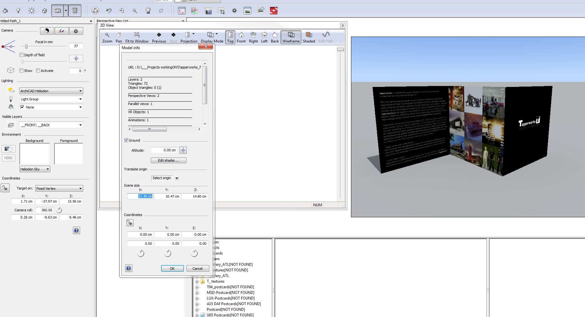

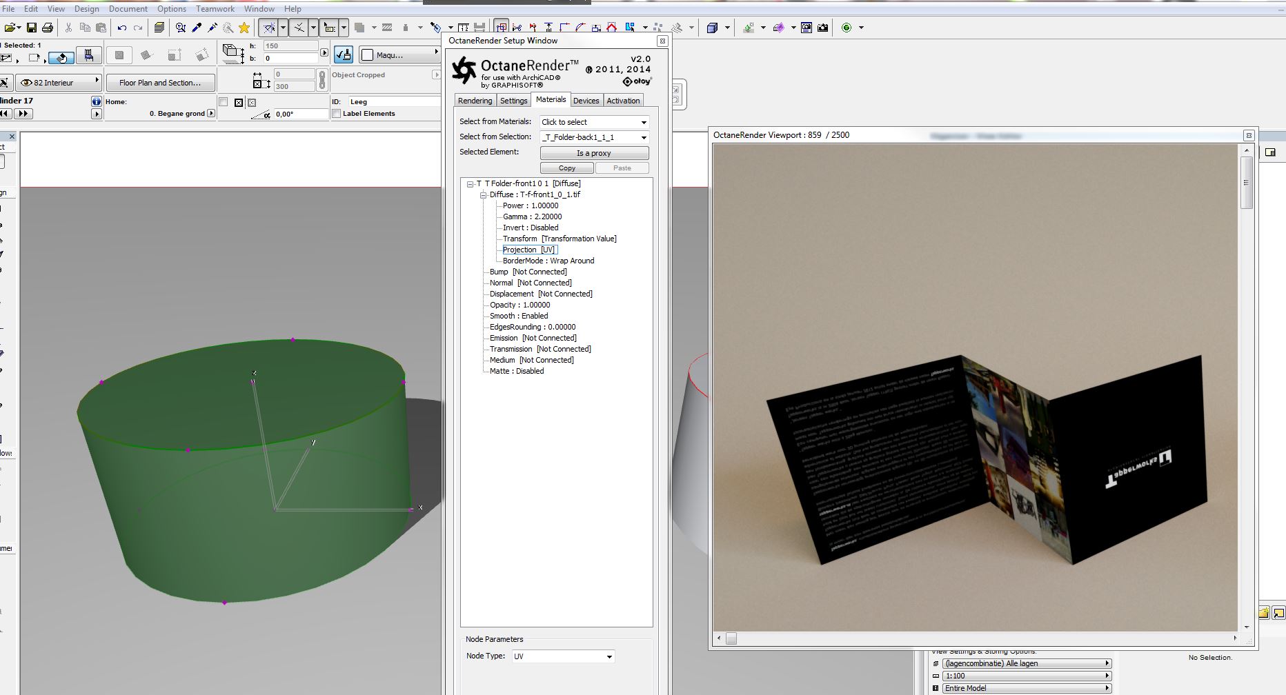

Hi Scottie,
I have exported an Artlantis scene to an OBj and imported it in Archicad plugin.
The UV textures are exported, but imported mirrored in the plugsin ?
When I re-open the OBj in Artlantis the texturemaps are mirrored too, so it is not a problem of the plugin, but the way Artlanti exports it to OBJ.
I am using Artlantis 4 by the way... maybe it is improved in artlantis 5?

greetz,

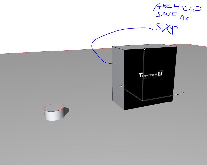

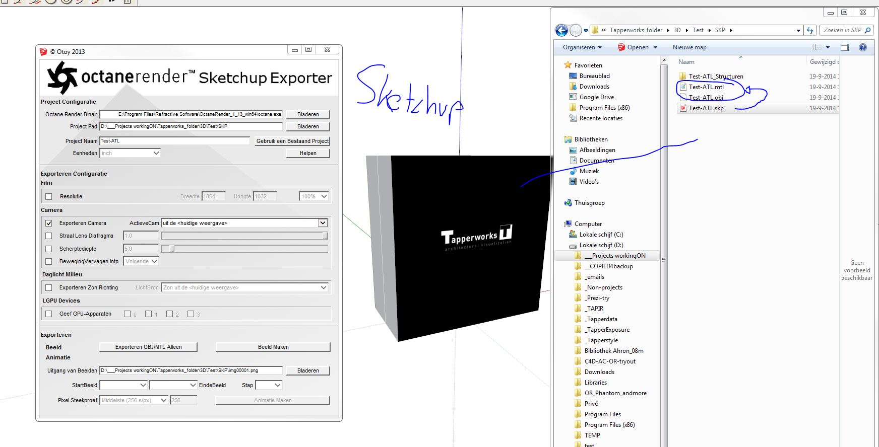

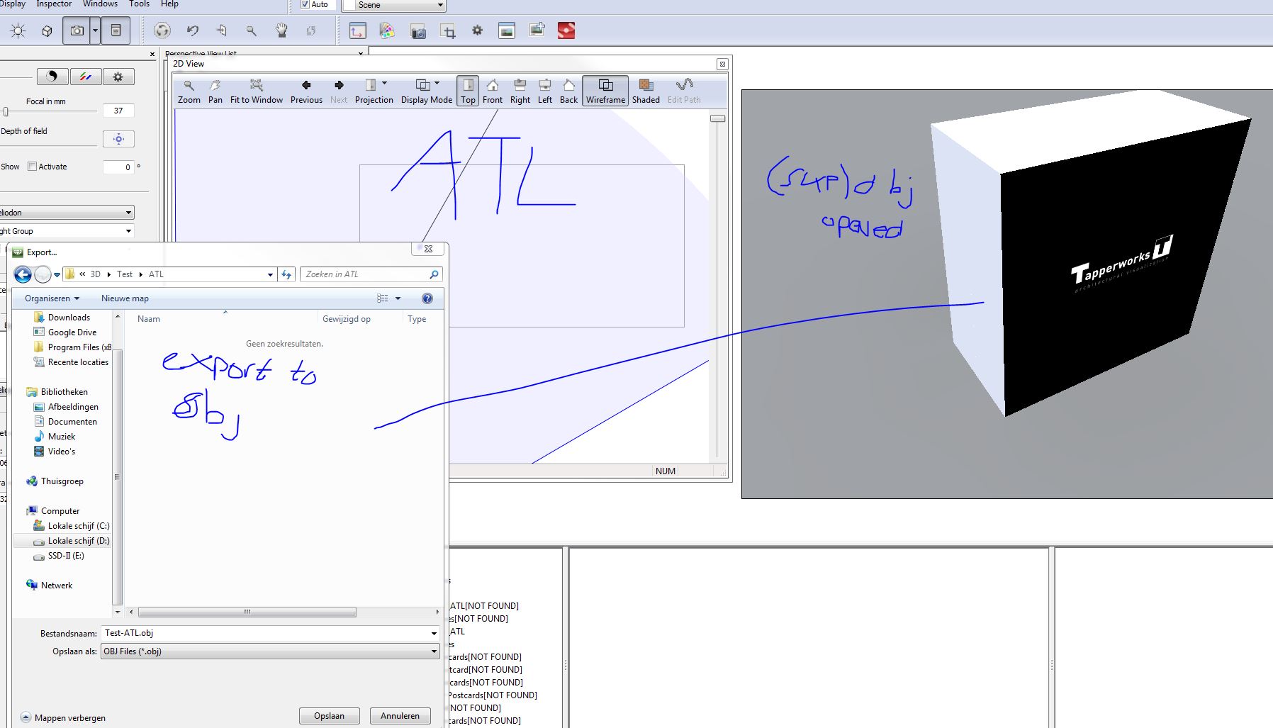

Hi Scottie,
Ok, maybe the scene I started with in ATL had something strange with UV or something.. so to be sure I started a scene from scratch.
I have made a scene 100x50cm and heigth 100cm adn made a material to give it a texture front and back.
Then I saved only that object to SKPs. Then I opened Sketchup and used the Octane exporter to save it as an OBJ.
(When saving from Archicad directly to an OBJ, the UV is not good, that's why I use Skecthup as inbetween) Then I open the OBJ in Artlantis and export it again to a new OBJ. So Now I have one OBJ from Sketchup and one from Artlantis

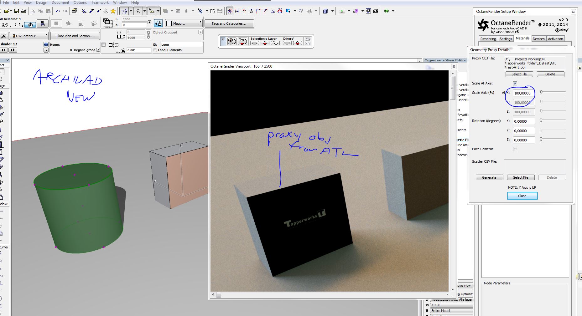

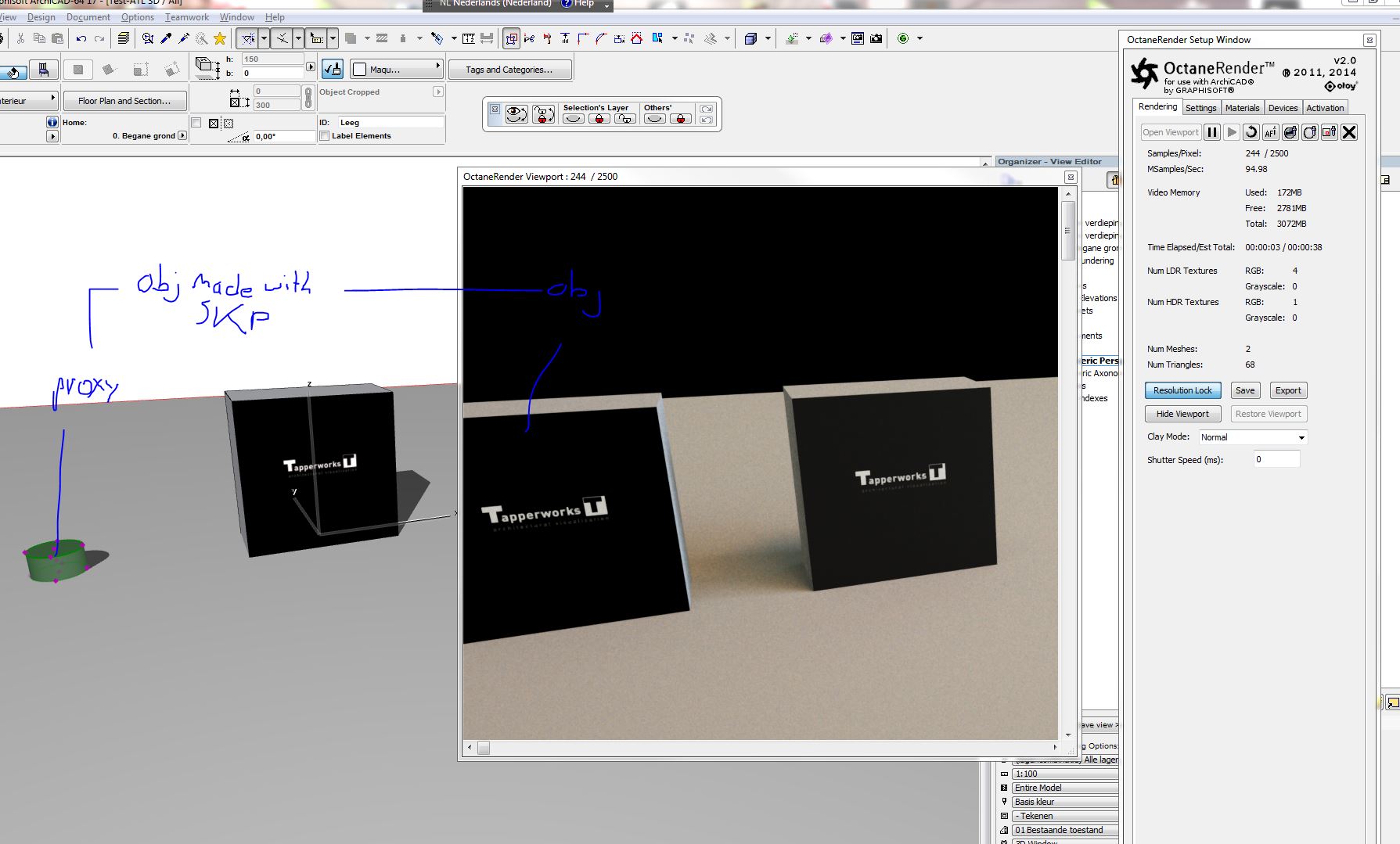

In sefperately Archicad files I used the OBJ as a proxy with scale 100% and they are both fine.
So my conclusion is taht when having the scene UV-ed properly it is possible to have a good export from Artlantis to OBj to be used as correct proxy. greetz,
