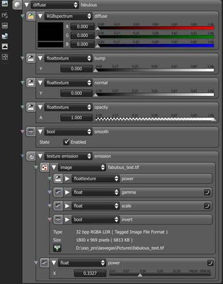

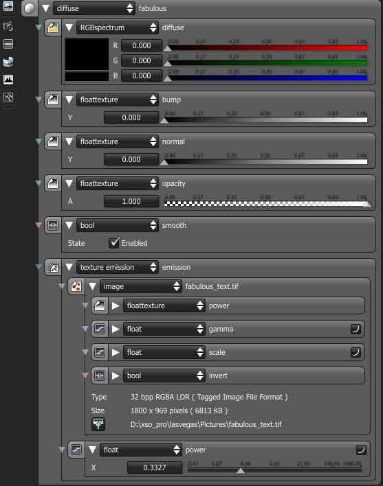

I'm trying to render a night time image with this model, but have a problem with the texture I'm using in the "to fabulous Las Vegas Nevada" object. It becomes completely white when using it as a diffuse texture-emission, and the blue letters disappear, (red letters "las Vegas" is a different object).
Any help?

Instead try to make an alpha of your image and use a mix material and then for both the letters and background use texture emission.

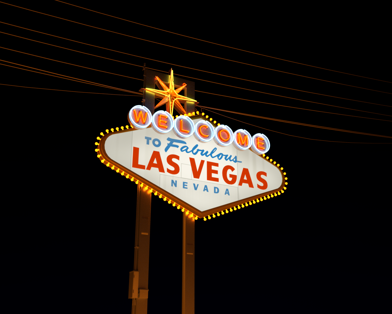

MaTtY631990, I couldn't do it with a mix-material, instead, I used a diffuse one and applied the image directly without alpha. I think I didn't explain it correctly, red letters where not the problem, they are an independent object with its own material, the issue was with the blue ones.
