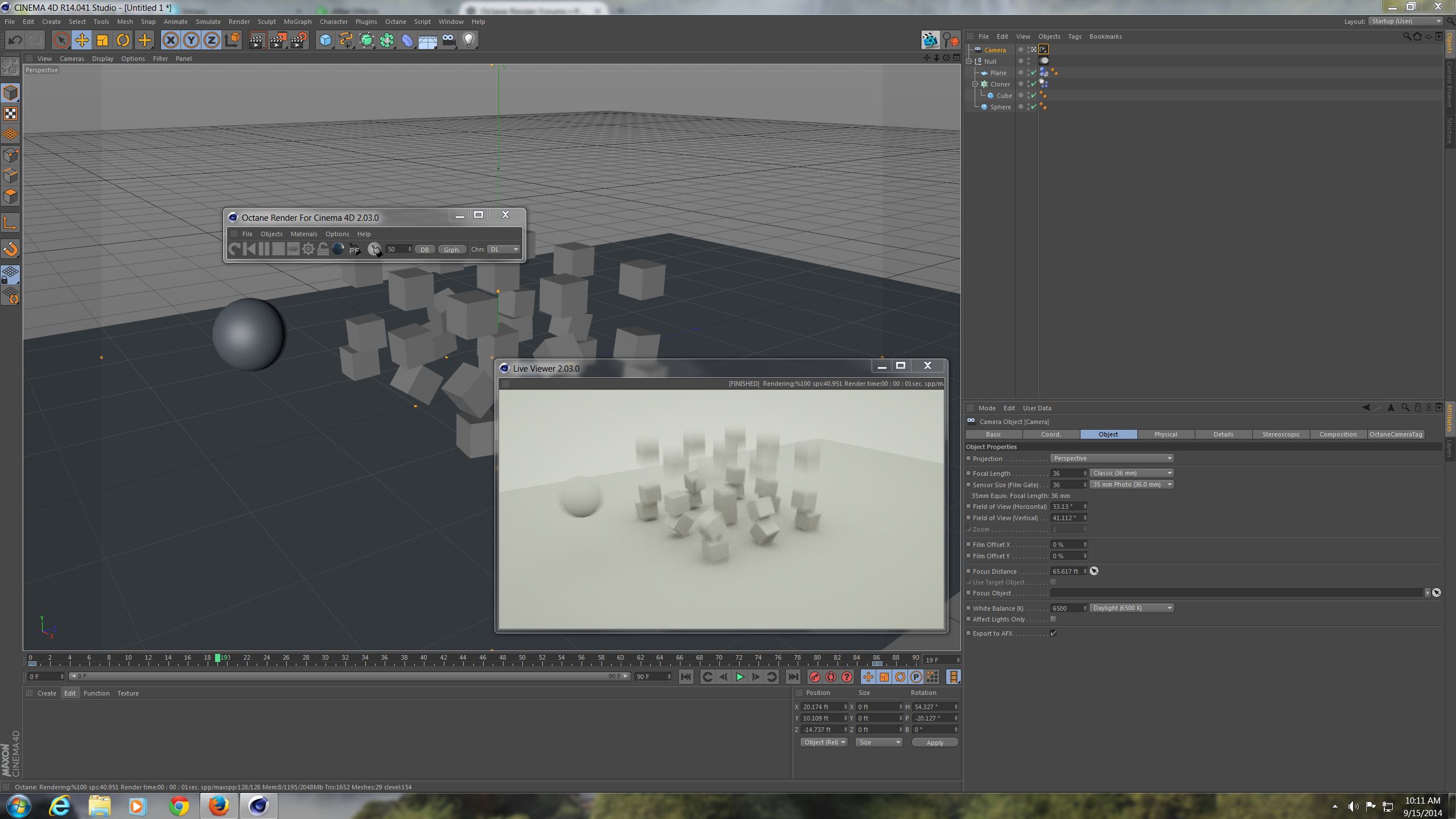

Hey all,
Just wondering if there is a way to turn on full motion blur on everything without having to add an object tag to each object in the scene? Is this possible?
Thanks,
Mike (beeple)
Posts: 16068
Location: Türkiye
i think that you are meaning to get transform+vertex motionblur on objects. right? Object motion blur requires a "transform node" for each objects. Transform node provides PSR for defining the transform values of objects.
if you don't put a objecttag, so you can't get transform motion blur. These objects will be exported to a single mesh. this is very similar to connect meshes.
ATM, we don't have a auto method to do this for you. Also I don't advice to activate vertex mblur option for unnecessary objects. Just a info.

I may be speaking out of turn here, but putting everything (in a very simple scene) under a null, and then applying the Octane object tag to the null solved it for me.

yes sure! A objecttag will affect all childs

Aye, yeah i thought of that but just wanted to make sure i wasn't missing some setting... thanks much!! :)
