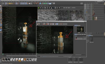

Hello aoktar, I searched but cant find where is the problem.. In Live viewer the image is ok, but when I render to the picture viewer, the object UV get totally out. Im Using Cinema R16, and I can not use NG, because if I click on it Cinema crash as soon the window onpens.

finally figured your problem. You used cylindrical projection node in imagetexture. This requires object transforms which is assigned. LV provides this when you use Octane Objecttag. Because this object will be exported as single mesh which is connected to a transform node. But when you render the scene with "send all data", all objects will loose transforms and collected to a single mesh.
Solution is simple, change it to "Resend only update objects". this is same as LV (interactive workflow)

PERFECT!!
